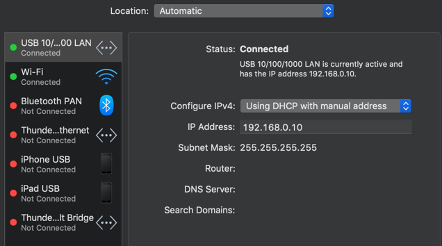

Unique problem (at least I think I've searched everywhere on this forum and the interwebs). I have a MR3020 V1.9 with Meteobridge from Ambient Weather. I changed my house wifi password, so the MR3020 no longer connects to the wifi. Therefore I am trying to connect to the MR3020 through the cabled ethernet connection. I have an Anker USB to GigE adapator (because Apple MACs don't have native enet anymore). I set IPV4 to "using DHCP with manual address" and set the IP address to 198.168.0.10. It automatically gives a subnet mask to 255.255.255.255. But it does NOT show a "router" address, which should be the MR3020 address (I know this because when a do the same thing with a MR3040 that I have for travel it shows the router address). see attached screenshot.
I have tried to reset the MR3020 to factory defaults (hold down button for 5 blinks) - which should mean I can get to the router with IP address 192.168.0.254. But the browser (firefox) times out every time. I've tried some other IP addresses as well, but nothing works, and the MR3020 just sits there with the fast-flashing LED. Any advice would be appreciated!

If you’re trying to access the MR2020 settings to change it’s Wi-Fi password to your new home password and are trying to access it via your USB LAN Adapter, I believe you need to turn off Wi-Fi in settings. Having two active connections just confuses your browser.

Tried it with the wifi off. No luck. Also tried again when resetting the MR3020. no luck :?

I think you’re going to have to go and setup your Meteobridge as if you just downloaded and installed the Meteobridge firmware from the WiKi on a non modified MR3020. You’ll need to configure your Mac to access your router using DHCP and use one of the recommended tools or the alternative USB Thumb Drive method listed in the instructions to find out the IP address assigned to your Meteobridge by DHCP. I don’t believe the default ip address is useable once you’ve reset the Meteobridge to it’s default DHCP setting.
If this doesn’t work, it’s possible that you have somehow corrupted the Ambient Weather version of the Meteobridge firmware they installed in your MR3020 in which event you’ll need to contact Ambient Weather for technical support as You won’t be able to reload the firmware using the version available from the Wiki without loosing your license.
