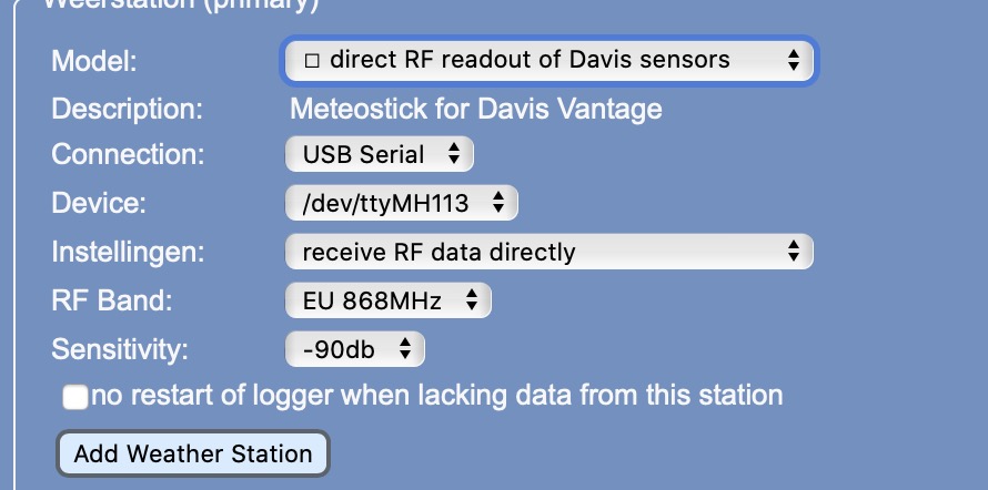

In the Station / Primary Station tab I have configured an added sensor #3.

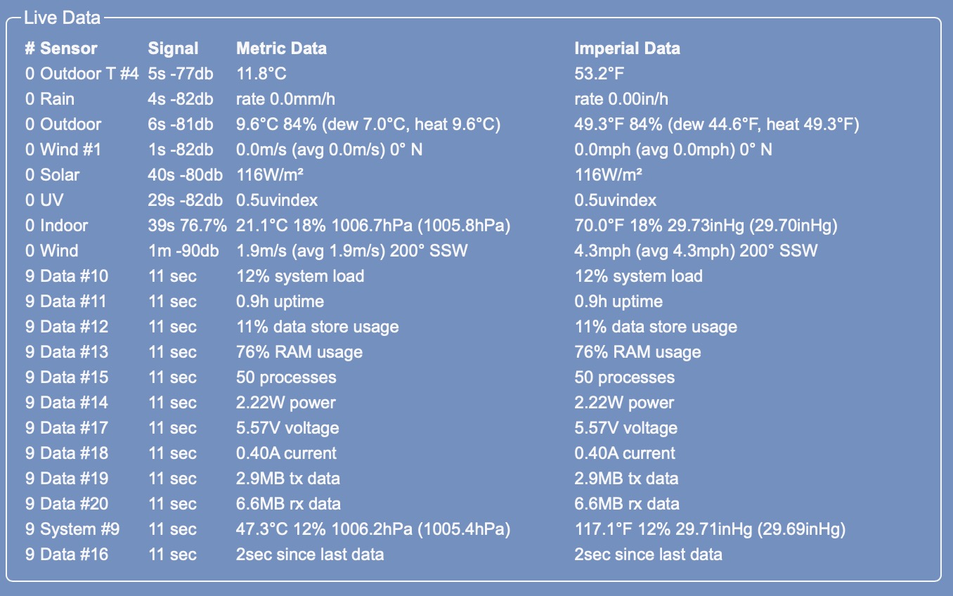

This always worked fine. Now the station is no longer visible in the Live Data / Raw sensor data tab for inexplicable reasons.
Schermafbeelding 2020-10-20 om 11.34.50.jpg (221.01 KiB) Viewed 1796 times
I did a reboot of the MB pro, but it didn't work.
Can someone tell me what could be causing the sensor #3 to no longer be visible with Live Data / Raw sensor data?

I think RF data is simply not received, no SW problem. Wind data looks also very weak (-90db). What is your RF treshold?

Your screen shots show a RF reception problem to me. You are getting wind data at -90db which is also the threshold. So my guess is that RF comes in rather weak and that data from wind transmitter might be cut off by the threshold here and there. Cold and wet days/nights can reduce RF reach.

There appears to be a malfunction in the transmitter board.
I assumed that if the signal is insufficient, this will be indicated permanently in red on the raw sensor data tab. Apparently the data disappears from the overview of the tab after a while when no more signal is received.
So problem is solved.
