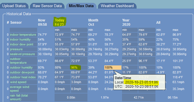

I just noticed an odd thing in my Humidity Min/Max Data. As you can see from the screen capture below, the Outdoor Humidity Max value for Today (October 23 @ 09:58) is 96%. However, the MAX Humidity value for the Month of October is 100%, with a date and time value of 2020-10-23 05:51:06.

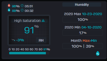

When I look at the History for October 23 the maximum value shown is 96%. This is also reflected in Brian's Template - shown below, since the data comes directly from Meteobridge.

After more research, I found a bad data point (Month - Max Humidity 100%) in the VP2 Console. Meteobridge was simply reading the data.
