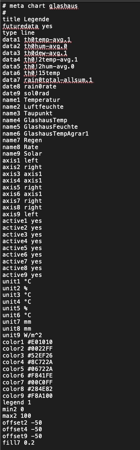

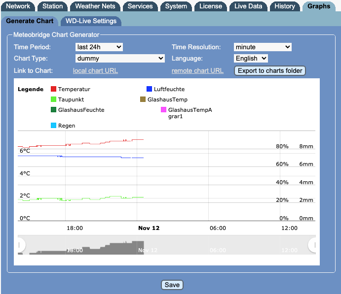

I want to make a metachart with several different temperature stations. Sadly the grafik doesen't appear, when i upload the metachart in my /upload.html templates folder. File attached and also a screenshot of the sensors, i have available. Can you help me out?

Could you please post your chart definition as text, otherwise it is hard to give it a try.

# meta chart glashaus
title Legende
futuredata yes
type line
data1 th0temp-avg.1
data2 th0hum-avg.0
data3 th0dew-avg.1
data4 th0!2temp-avg.1
data5 th0!2hum-avg.0
data6 th0!15temp
data7 rain0total-allsum.1
date8 rain0rate
date9 sol0rad
name1 Temperatur
name2 Luftfeuchte
name3 Taupunkt
name4 GlashausTemp
name5 GlashausFeuchte
name6 GlashausTempAgrar1
name7 Regen
name8 Rate
name9 Solar
axis1 left
axis2 right
axis3 axis1
axis4 axis1
axis5 right
axis6 axis1
axis7 right
axis8 right
axis9 left
active1 yes
active2 yes
active3 yes
active4 yes
active5 yes
active6 yes
active7 yes
active8 yes
active9 yes
unit1 °C
unit2 %
unit3 °C
unit4 °C
unit5 %
unit6 °C
unit7 mm
unit8 mm
unit9 W/m^2
color1 #E01010
color2 #0022FF
color3 #52EF26
color4 #8C722A
color5 #06722A
color6 #F841FE
color7 #00C0FF
color8 #284E82
color9 #F8A100
legend 1
min2 0
max2 100
offset2 -50
offset4 -50
offset9 -50
fill7 0.2
title Legende
futuredata yes
type line
data1 th0temp-avg.1
data2 th0hum-avg.0
data3 th0dew-avg.1
data6 th0!15temp
date8 rain0rate
date9 sol0rad
name1 Temperatur
name2 Luftfeuchte
name3 Taupunkt
name4 GlashausTemp
name7 Regen
name8 Rate
name9 Solar
axis1 left
axis2 right
axis3 axis1
axis4 axis1
axis5 right
axis6 axis1
axis7 right
axis8 right
axis9 left
active1 yes
active2 yes
active3 yes
active4 yes
active5 yes
active6 yes
active7 yes
active8 yes
active9 yes
unit1 °C
unit2 %
unit3 °C
unit4 °C
unit5 %
unit6 °C
unit7 mm
unit8 mm
unit9 W/m^2
color1 #E01010
color2 #0022FF
color3 #52EF26
color4 #8C722A
color5 #06722A
color6 #F841FE
color7 #00C0FF
color8 #284E82
color9 #F8A100
legend 1
min2 0
max2 100
offset2 -50
offset4 -50
offset9 -50
fill7 0.2

Copied the above definition "as is" in a file namend "dummy.metachart" in folder "Templates" and it works...

ok but i still don't see the special temperatures or humidities at your chart ... "GlashausTemp, GlashausTempAgrar1, Glashausfeuchte" ... they don't appear at your chart?!

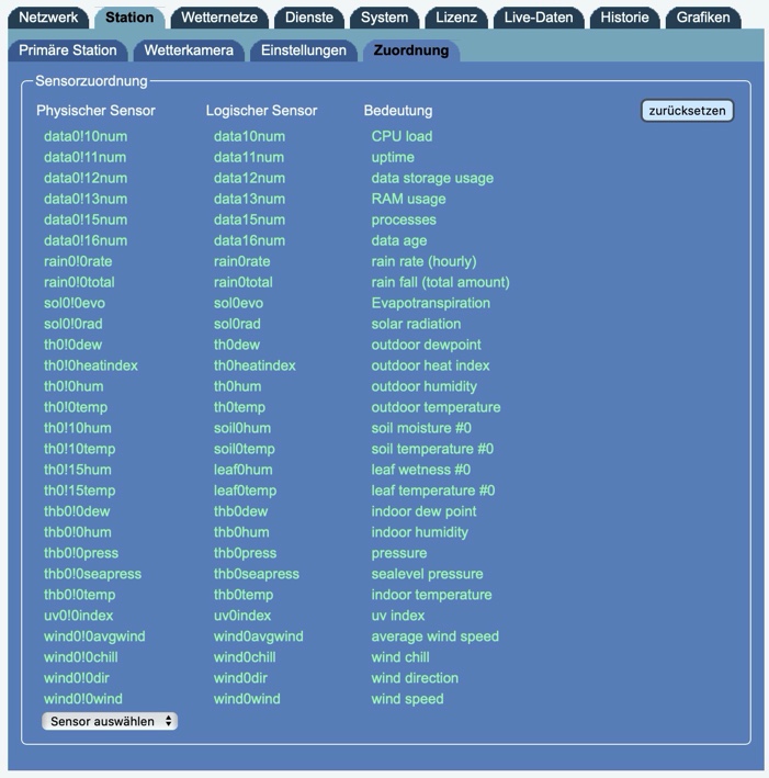

Why should they appear? Per your definition data from "th0!1temp" and "th0!15temp" should be used. My Meteobridge setup does not provide data for these physical sensors. So no surprise at all. I would recommend to use logical sensors "th1temp" and "th2temp" in the graphic definition and to map the physical sensors of the specific Meteobridge to these logical sensors (to be done on "station - mapping" tab.Wetterring wrote: Mon Nov 23, 2020 8:02 pm ok but i still don't see the special temperatures or humidities at your chart ... "GlashausTemp, GlashausTempAgrar1, Glashausfeuchte" ... they don't appear at your chart?!
Please get rid of the idea, that you define a chart with some invented sensor names and by magic any Meteobridge will feed data to it. It needs your configuration of the specific unit when you are going beyond predefined standard sensors.
