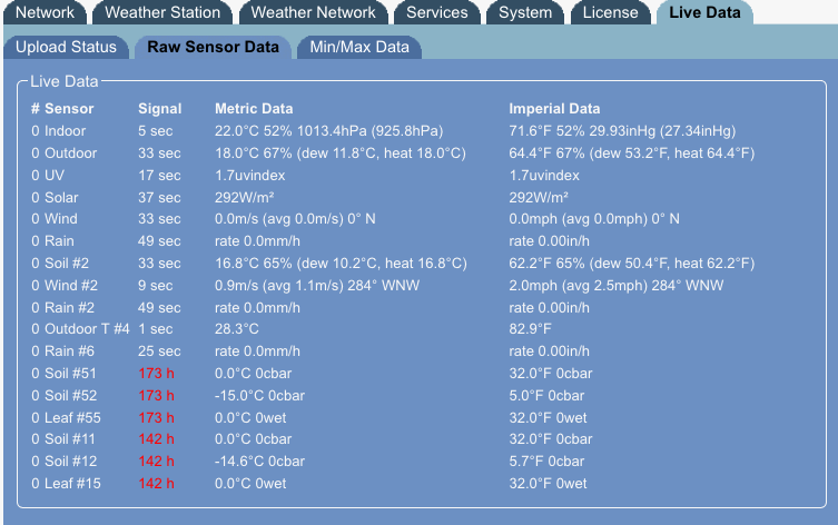

On "Raw Data" tab I see the mentioned Soil #2 sensor.
Bildschirmfoto 2020-11-16 um 12.38.21.png (112.53 KiB) Viewed 1782 times
On "Min/MAX Data" tab I see the corresponding entry, that has been individually mapped by you to "extra temp #2" and "extra hum #2". You can also change this mapping a soil temp/wettness #1 - #4 on "Mapping" tab.

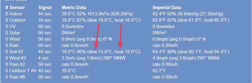

I think a soil sensor does not really provide heatindex or dewpoint, at least I am not aware that this is used/expected.
Which issue do you have with this?
