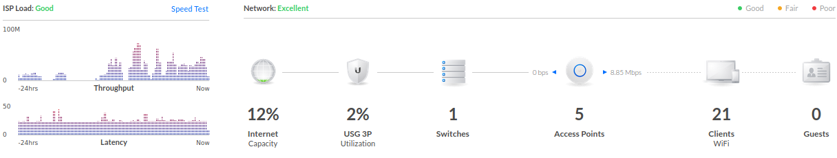

My Nano SD webpage started to get real slow, so I decided to reboot it. That was a mistake. It is now fast blinking which I believe indicates that it can't access the 'internet'. Internet is working as you're reading this message. Looking at my weather stations reports on Findu.com it shows several dropouts in data so something is going on with the device.
I can access the local webpage which says:
yes	Connected to WLAN with IP 192.168.200.15
no	Internet cannot be reached
no	Meteobridge server cannot be reached (DNS issue?)
Currently it is hard-coded to a static IP. It was previously DHCP but now does not get to the internet with either. It does get an address from DHCP though.
My internet connection has been stable. I don't see anything being blocked by my local DNS (PiHole). Everything has been whitelisted at the DNS.
I've also tried reserving the IP at the router.
It doesn't look to be a local network issue, it appears to beyond my local network.
