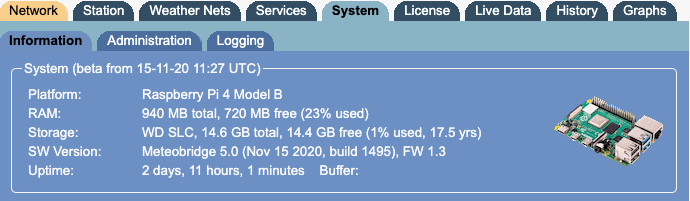

"Storage" row adds an estimate how many days/years of additional data the SD card might be able to store. This is computed from the daily increase of the DB size compared to available storage. Therefore numbers will go crazy when you store large files on the SD card or import data. When Meteobridge is in standard operation for a day or two, you can expect realistic estimates.

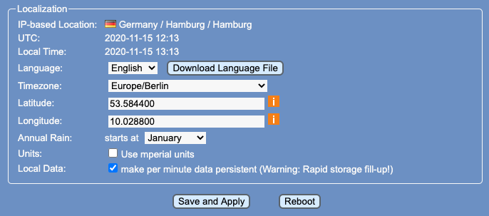

Feature needs to be switched on here (please don't forget to press "Save and Apply".

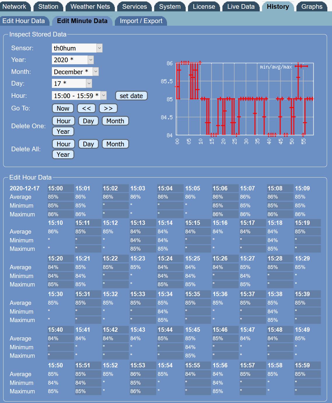

Editing per minute data is working exactly as with hourly data before. Changes done on the per minute data are not propagated to hourly/daily/monthly/yearly data. If you want to achive this you also have to do changes on the "Edit Hour Data" tab.

What happens after 17.5 years when the storage fills up? Is there a way to manage keeping say the record high/low but throw out the per minute data that is older than say 16 years?
Can you change the recording interval to every 5 minutes instead of every minute? That would right there extend the life to 87.5 years.

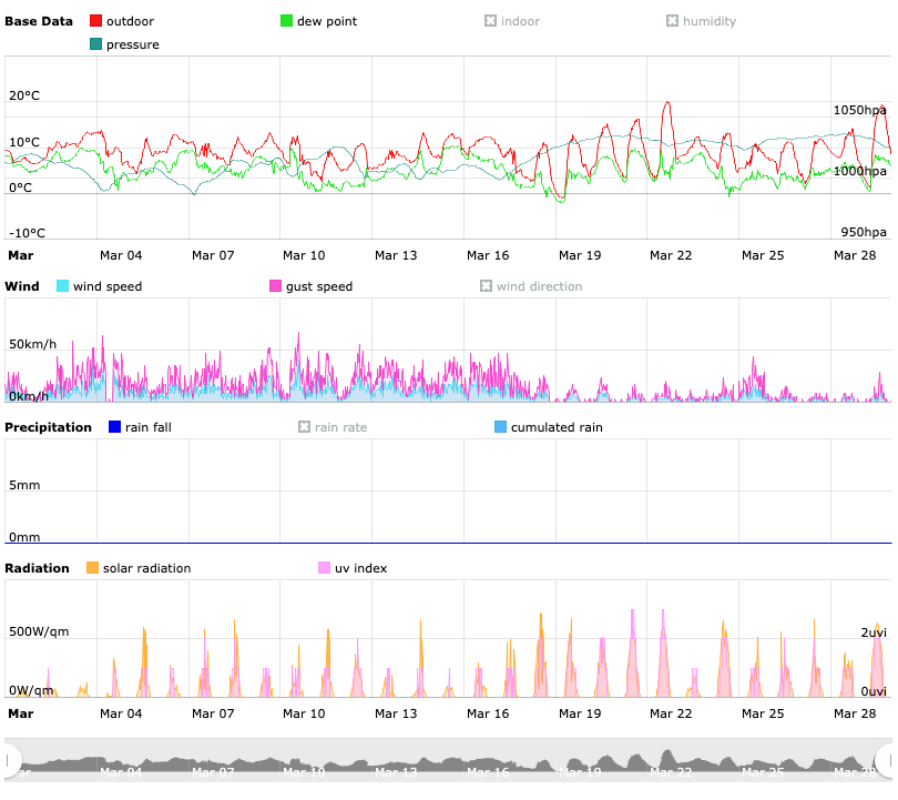

Logging data on per minute schedule allows some really exciting charts. Attached you find an interactive chart in per-minute resolution for a complete month. The chart is HTML with embedded javascript and about 6 MB of size. NANO SD needs about 60 seconds to generate this chart, RPI 4 about 5 seconds.
Link for self inspection: https://admin.meteobridge.com/files/dem ... 01903.html

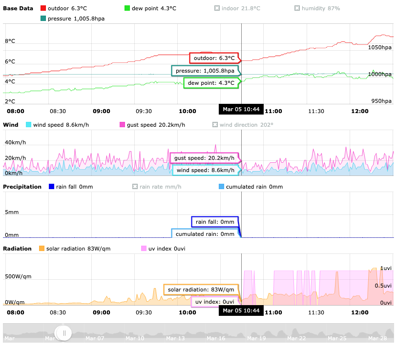

When you call it you get the complete view of the month. Selection of a time period is rather simple by just stating the "start" and "stop" time marker on the calling URL. Example below charts the complete March 2019 in per minute resolution:
By moving the ruler at the bottom you can zoom into any time frame down to inspection on minute level.
http://192.168.1.xxx/public/chart.cgi?chart=allinone-iso.chart&res=min&lang=en&start=20190301&stop=20190401By moving the ruler at the bottom you can zoom into any time frame down to inspection on minute level.

The with 14151 introduced per minute data storing and editing seems to work on the MB Pro.
I only noticed some "beauty error" - in the per minute section it says "edit hour data" - that
should be "edit minute data", shouldn't it ?
See attachment

Thanks, will be fixed with next update.
