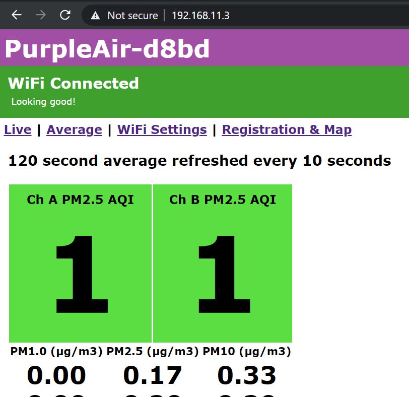

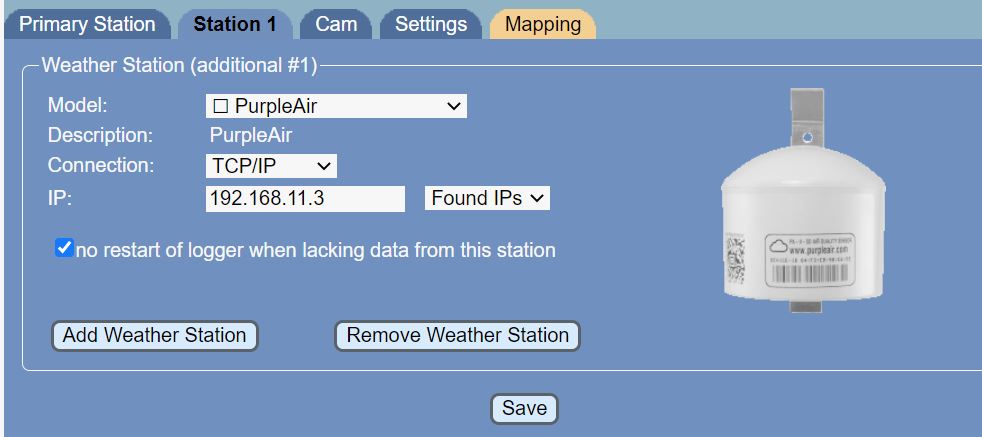

Here's the page from my PA II: Here's my Station configuration page in Meteobridge: I still see no data. Is there another log file that reports on parsing of the PurpleAir data? That might provide a clue as to where the problem lies.

You can check the data with http://192.168.11.3/json in your browser.ice124 wrote: Mon Nov 30, 2020 5:02 pm I triple-checked the IP address before submitting my post.
