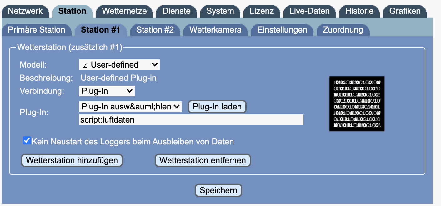

Hi Boris,
I've set my station#1 to not restart the logger on failures, but it still restarts if the device isn't returning data. Is this intended ?
Screen Shot 2020-11-29 at 19.26.33.png (172.37 KiB) Viewed 1273 times
logger (29.11.2020 18:27:33): station 1 (User-defined), no signal for 900 seconds, station to be restarted.
logger (29.11.2020 18:27:33): disconnect station 1 (User-defined): timeout
logger (29.11.2020 18:28:03): connect station 1 (User-defined via Plug-in).
logger (29.11.2020 18:28:03): station 1 (User-defined), no synchronization for 900 seconds, data logger will be restarted.
logger (29.11.2020 18:28:03): disconnect station 0 (Vantage): exit
logger (29.11.2020 18:28:03): disconnect station 1 (User-defined): exit
logger (29.11.2020 18:28:03): disconnect station 2 (AirLink): exit
logger (29.11.2020 18:28:03): disconnect station 9 (System Data): exit
logger (29.11.2020 18:28:04): data logger stopped.
logger (29.11.2020 18:28:04): databases disconnected.
logger (29.11.2020 18:28:04): parent process to be terminated.
Re: Logger restart despite setting
no, is not intended. Should be fixed with just released update.
