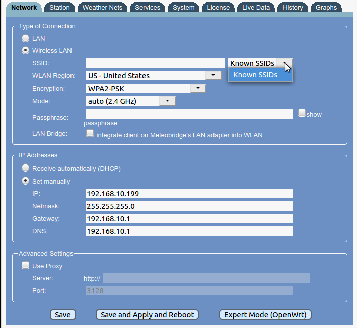

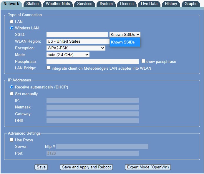

Has anyone gotten the Meteobridge RPI to work on WiFi? Just wondering if it is only me and if I should bother pulling a new image or not.
When I go to Network tab and select Wireless LAN, and then click the drop down for Known SSIDs I see nothing. I've selected WLAN Region but it makes no difference.
When I go into OpenWRT / Network / Interfaces, I only see the LAN port.

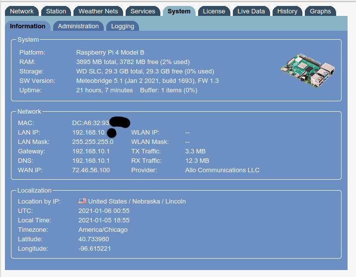

I'm running on Raspberry Pi 4B 4GB with WD SandDisk SDSDQED-016G-XI for the SD card. Using CanaKit 3.5A USB-C power supply for the Pi 4. Using Flirc aluminum case which is reported to be a good solution with good WiFi reception.
Empty Known SSIDs drop-down:

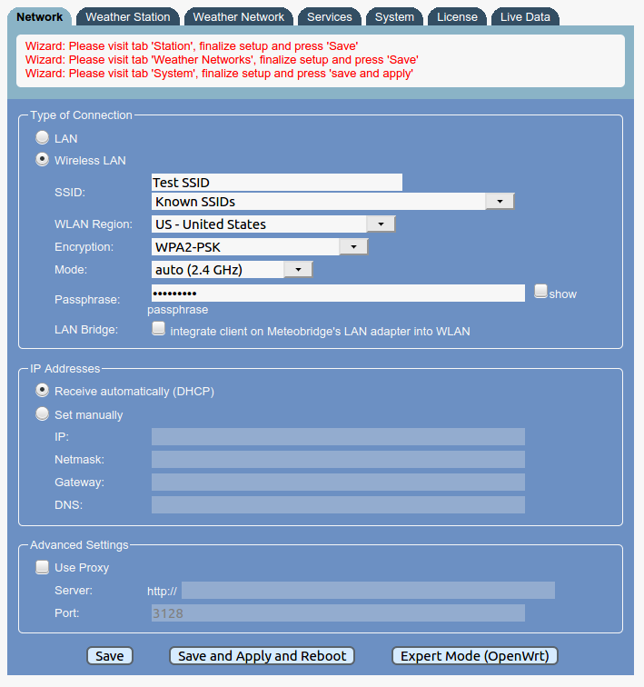

The RasPi got another ip-address as it is using another (W)lan connection.
I assume it can noly see the other wlan's when it is using the wlan chip.
Not when it is connected to a cabled-lan.

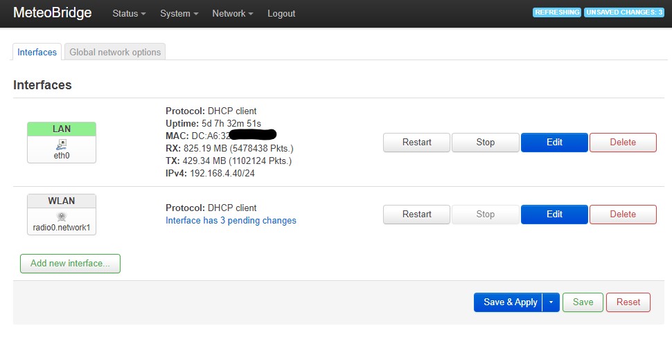

Okay I figured it out. I had to go into OpenWRT and turn things on. Maybe using WiFi is only possible when first setting up. I feel you should be able to go back an forth if needed as I do with my TP-Link.
Here are the steps that I performed to get WiFi to work:
- Go into OpenWRT mode
- Got to Network / Interface and add the wireless adapter (I called it WLAN) and select radio0.network1 device)
- Save and Apply and then Restart to implement pending changes
- Then got to Network / Wireless menu and click on Enable and then Save and Apply
- Go back to Meteobridge web interface and then you can finally select nearby WiFi networks to connect to.

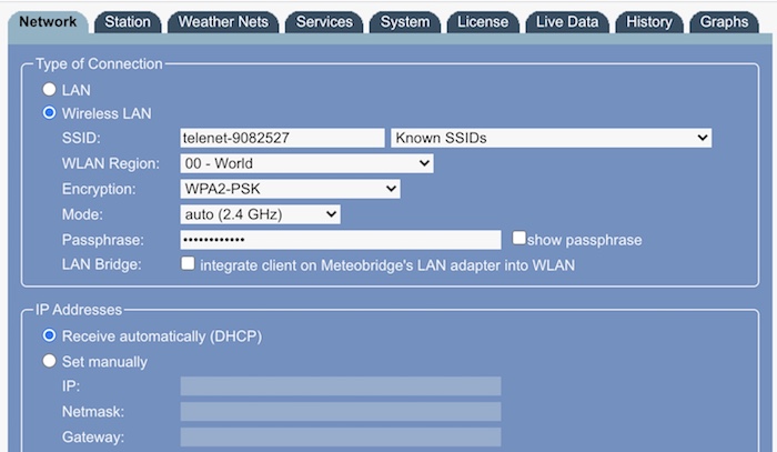

I’m still using my Nano SD but To test the RPi version I downloaded and installed the 3B+ version on a 3B+ I have using both a 2GB SLC micro SD card and also the newly added 8GB San Disk SLC micro SD card. I also downloaded the 4B version and installed it on a 16GB San Disk SLC micro SD card and installed it in my 4B.
They all booted up and configured just fine on wi-fi with all my networks appearing on the wi-fi drop down menu.

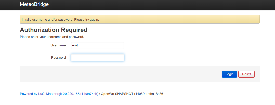

System info: After the initial setup, etc. I am unable to get a list of the available SSIDs. Now the catch - when I open OpenWRT to enable WIFI as noted above, I am unable to log into OpenWRT. The initial screen indicates an incorrect user / password. I have tried leaving the password field blank, used "root", "admin", "meteobridge", "passwd" and a few others, no login. Remembering back to when I did the initial install, WIFI SSIDs were available. So I grabbed another card, fired the RPI up. Went to the Network tab, and yes, WIFI SSIDs are available. But am still unable to login to OpenWRT. Also, if I save, apply, reboot with the WIFI enabled, it's dead on arrival after the reboot - I can't access it via LAN or WIFI. Thanks much -

I also at one point was not able to log into OpenWRT. I too tried a bunch of things. I forget what I did that finally got me in. I remember doing an SSH login with username root and then I think it prompted me for a password (maybe I used no password...can't remember) and then maybe I changed the password, and then I think that was what then allowed me into OpenWRT web interface. I should have paid closer attention but I didn't. I just did so many things that unless I tried to duplicate it I don't think I was really sure what it was that did it.

try user "root" and as password the default password for Meteobridge with which you log into the web interface.harphauler wrote: Wed Jan 06, 2021 5:18 am I'm having a similar WIFI issue on my RPI 4B. Along with a possibly related issue.
Thanks much -
If you have changed that, you might want to try the changed one.

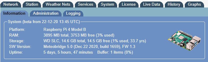

See you're running a 4 Gb micro SD chip I don't see listed in the approved SD card list. Wondering where you got it since I can't find it.galfert wrote: Sun Dec 27, 2020 9:28 pm I'm running on Raspberry Pi 4B 4GB with WD SandDisk SDSDQED-016G-XI for the SD card. Using CanaKit 3.5A USB-C power supply for the Pi 4. Using Flirc aluminum case which is reported to be a good solution with good WiFi reception.

Look again. My RAM is 4GB as I have a Pi 4 with 4GB RAM. The SD card I'm using is the WD/SandDisk 16 GB SLC SD that I got from Mouser and is available in 8, 16, 32, and 64 GB sizes:Andyk1 wrote: Thu Jan 07, 2021 5:28 amSee you're running a 4 Gb micro SD chip I don't see listed in the approved SD card list. Wondering where you got it since I can't find it.galfert wrote: Sun Dec 27, 2020 9:28 pm I'm running on Raspberry Pi 4B 4GB with WD SandDisk SDSDQED-016G-XI for the SD card. Using CanaKit 3.5A USB-C power supply for the Pi 4. Using Flirc aluminum case which is reported to be a good solution with good WiFi reception.

That solves it. Login on the Meteobridge web interface as root, password root. OpenWRT can then be accessed directly via the button on the network tab in the Meteobridge web UI.Gyvate wrote: Wed Jan 06, 2021 3:14 pmtry user "root" and as password the default password for Meteobridge with which you log into the web interface.harphauler wrote: Wed Jan 06, 2021 5:18 am I'm having a similar WIFI issue on my RPI 4B. Along with a possibly related issue.
Thanks much -
As a further followup, enabling WIFI in OpenWRT solves the no WIFI issue on the Meteobridge web UI. As an experiment I also did all of the WIFI setup in OpenWRT and that carries back to the Meteobridge web UI.
Thanks much!
