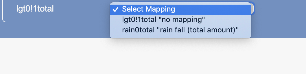

Setting custom mappings, Lighting Total and Rain Total are reversed.
lgt0!0total - will only allow selection of: rain0!0total rain fall (total amount)

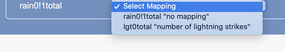

rain0!1total - will only allow selection of: lgt0total. number of lightning strikes
Screen Shot 2020-12-29 at 9.34.13 PM.png (127.07 KiB) Viewed 972 times

Thanks for spotting this. It is fixed with just released update.
