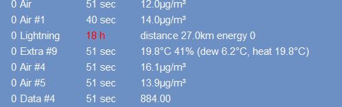

Please see
https://www.wxforum.net/index.php?topic=41084.0 for details -
don't want to write it again - in a nutshell - Meteobridge doesn't handle the new Ecowitt WH45 5-in-1 air quality sensor(s) properly.
(Firmware and API already available for 2-3 months)

Same experience with my new WH45. Wrong data showing up.
Gyvate has extra GW1000 and it would be best for Boris to remote into his MB. I disconnected my WH45 because WeeWX crashes.

Boris is working on/in/at my test MB Pro and has first findings
Gyvate
Posts: 458
Re: MB Pro shows messed up sensor data for Ecowitt WH45 5-in-1 air quality
Post by Gyvate »
Error detected in a joint effort - Boris will provide the fix with next release (update).
