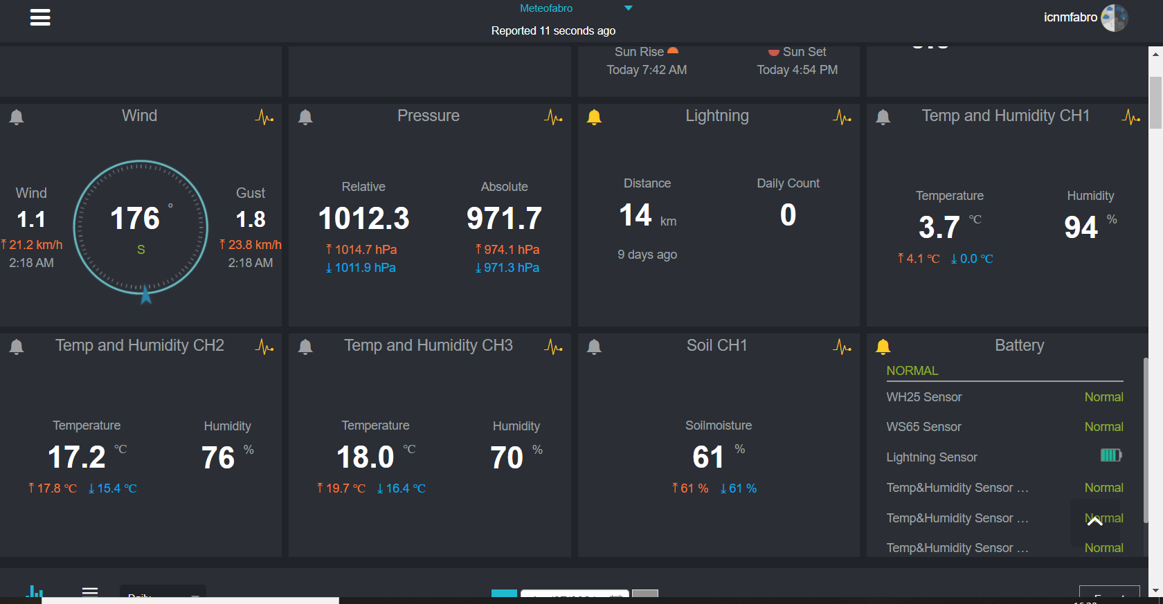

I would like to make a template for a graph that represents on my second station connected to the Meteobridge PRO, the temperature and humidity of the three internal extra sensors located in the house, "Temperature and Humidity CH1, CH2, CH3".
Also I would like to create another template, again for a graph, for the soil moisture sensor "Soil CH1".
I can't figure out how to map the variables or what variables I have to select in the mapping.
Some idea?
I attach images of the sensors on ecowitt.net

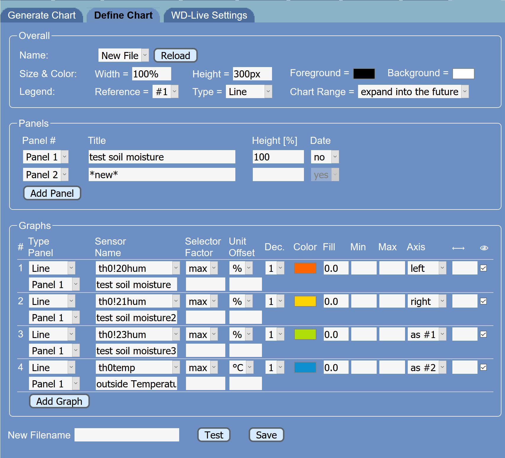

Did you read the wiki in order to know how to create your own template in principle ?
If so, you "just" have to choose the proper sensors.
And "play around" until you have it all together.
You find them all with their names in either the live data or, even better, in the min/max data.
Or in the History.
Another possibility is the new feature of creating charts interactively (Graphs --> Define Chart).
Did you give that a try already ?

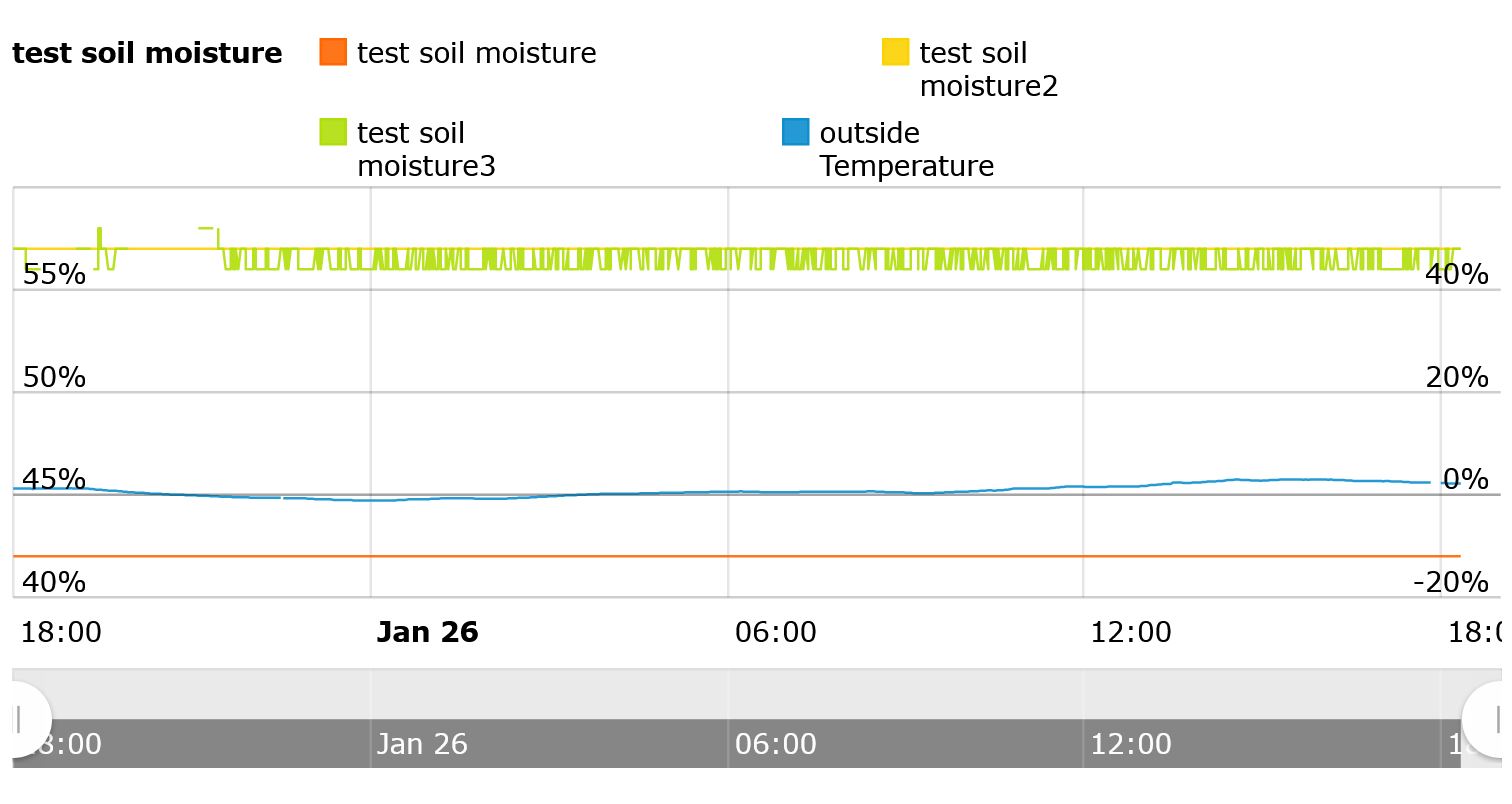

the sensor names for soil moisture are th0!2xhum x=0-7
respectively th1!2xhum etc. depending on your station definition
an example could be result (not extraordinary looking but something to start with)
