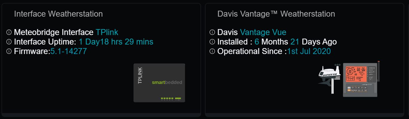

The Davis forecast data is not being uploaded to Weather34:
looking at your meteobridge upload file there is no forecast/outlook present
22/01/2021 11:19:40 9.1 55.0 0.6 2.7 2.4 6.0 0.0 0.0 1020.4 32.0 2 m/s C hPa mm 2.2 1020.4 26.4 26.4 0.3 18.8 41.0 7.8 8.1 9.2 20210122111747 4.0 20210122050840 3.4 20210122090804 7.0 0.2 1020.6 20210122102207 1013.2 20210122044419 5.1 14277 5.4 5.3 -- -- 0.0 -- 26.0 0.0 8.4 20210121114033 -7.4 20210112055917 8.4 20210121114033 8.4 20210121114033 -7.4 20210112055917 0.0 97.0 20210122042549 55.0 20210122105844 5.4 20210122011229 0.2 20210122105918 8.8 56.0 0.4 18.7 41 2.0 2.1 -- -- 17009804 0 0 0 0.0 154526 11.6 20210121141651 5.4 20210121000006 16.8 20210118150911 -6.6 20210112055917 16.8 20210118150911 -6.6 20210112055917 2.4 20210121005613 7.9 20210101002804 7.9 20210101002804 0.3 26.4 20200223184921 26.4 20200223184921 0.0 20210122000010 0.0 20210121000006 0.0 20210101000010 0.0 20210101000010 20210122000010 0.0 20210121000006 0.0 20210101000010 0.0 20210101000010 4.7 20210121234656 166.1 0.2 20210121032729 38.9 20200613181357 -6.7 20201225072642 29.9 20200702163829 -15.7 20200306173748 16.0 20200827170548 1018.2 20210121000006 1013.9 20210121204706 1031.0 20210120021647 1004.2 20210101020645 1031.0 20210120021647 1004.2 20210101020645 1035.5 20200307091735 995.1 20200608202137 1504.1 5.7 2 66.8 10:14 12:38 01:48 1.1 98.0 20210101070224 25.0 20210118132650 98.0 20210101070224 25.0 20210118132650 97.0 20210121010409 72.0 20210121135111 132.5 2.4 -- -- -- 922.0 20200517121730 14.6 20200505134255 -- -- -- -- -- -- -- -- 111.7 4 1 166.1 16.8 20210118150911 -6.6 20210112055917 _
it should have the outlook forecast at the end of the file like this
22/01/2021 09:33:00 3.8 91.0 2.5 5.0 2.4 240.0 0.0 11.0 984.7 208.0 2 m/s C hPa mm 4.7 984.0 90.0 90.0 0.2 22.4 42.0 1.7 4.0 6.4 20210122041012 2.2 20210122055010 5.4 20210122010528 12.9 5.7 985.1 20210122000034 977.7 20210122042430 5.1 3738 10.4 -0.9 -- 0.0 11.0 62.0 210.0 0.0 7.4 20210119231505 -5.7 20210115150344 5.3 20210121084253 7.4 20210119231505 -5.7 20210115150344 0.0 96.0 20210122032658 78.0 20210122000000 5.8 20210122041012 1.5 20210122055010 3.8 92.0 2.6 22.4 42 4.4 4.4 -- -- -- -- -- -- 62.0 123541 10.0 20210121083625 5.9 20210121232302 10.0 20210121083625 -3.9 20210116080248 10.0 20210121083625 -3.9 20210116080248 24.9 20210121084255 24.9 20210121084255 24.9 20210121084255 0.2 90.0 20210101000040 90.0 20210102000111 62.0 20210122092930 346.0 20210121123208 346.0 20210121123208 346.0 20210121123208 20210122000009 0.5 20210121122813 2.6 20210112103259 2.6 20210112103259 1.3 20210121135021 251.0 5.7 20210122063832 31.8 20200816145445 -3.9 20210116080248 20.7 20200810132336 -13.0 20200329175211 24.9 20210121084255 991.5 20210121000031 982.6 20210121075933 1028.7 20210115193534 977.7 20210122042430 1028.7 20210115193534 977.7 20210122042430 1044.7 20200120101900 975.8 20200210014000 915.4 4.4 2 63.4 08:17 11:56 02:26 3.0 98.0 20210101221614 62.0 20210121135021 98.0 20210101221614 62.0 20210121135021 82.0 20210121093041 62.0 20210121135021 190.0 24.9 96.6 825.4 8.4 1281.0 20200715133911 6.0 20200703135441 -- 2.6 8.4 -- 1.9 5.3 8.4 14.9 215.0 6 2 251.0 10.0 20210121083625 -7.3 20210110044727 _Mostly cloudy and cooler. Precipitation ending within 6 hours. Windy with possible wind shift to the W, NW, or N.
this is obviously something within meteobridge itself which I have no idea why it is not present in your upload . try rebooting meteobridge again to see if it appears that is all I can think of .
