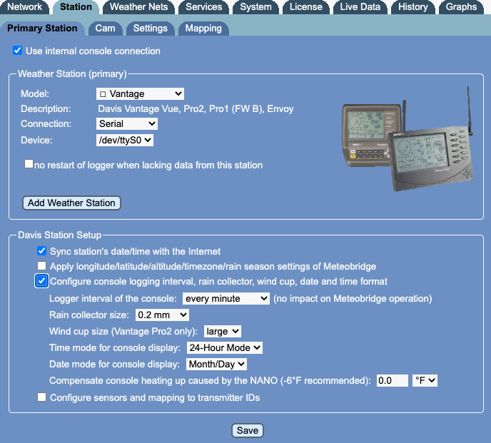

I've replace a Meteobridge TpLink with a Nano SD. Everything works fine, except the Vantage Pro2 console temperature readings are high. The release from August 26, 2018 mentions:
Meteobridge NANO: adds a feature to compensate for heating-up the console a bit by the NANO plug-in. This results into higher indoor temp readings as they actual are. An offset to compensate for that can be specified in Fahrenheit or Celsius. Recommended value is -6° Fahrenheit.
The Primary Station setup for Vantage in version 5.1 does not appear to include this option.
What's the best way to compensate for the Nano SD console heating?
VP2+ Nano SD & Pro2
Re: Nano SD Console Heating Compensation
It is still there:
Bildschirmfoto 2021-01-23 um 07.22.04.png (149.1 KiB) Viewed 832 times
