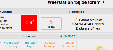

Thanks everyone for the contribution. What I don't understand is the time. On the website, the time is indicated differently than what meteobridge indicates. I am still puzzling with that. See Appendix.
Engelbert
Engelbert
- tijd.png (95.66 KiB) Viewed 4071 times
- bliksem.png (17.04 KiB) Viewed 4071 times

Seems that you did not unzipped/installed the zip from my post above?engelbert wrote: Wed Feb 10, 2021 1:02 pm Thanks everyone for the contribution. What I don't understand is the time. On the website, the time is indicated differently than what meteobridge indicates. I am still puzzling with that. See Appendix.
Engelbert
That new version will take care of that.
Re: meteobridge and physical names
Of course i unzip and uploaded your attachment directly to my site. only the date and time is not correct yet. Maybe it is the upload time of meteobridge.
