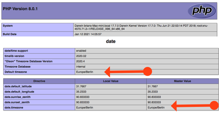

ill try and help but this is a local server environment anomaly .
in wamp itself on the root server directory run a phpinfo.php (it can actually be called anything as long it contains the code <?php phpinfo();?>)
this will pull up what the actual default timezone the installation is using .
if its not America/Vancouver then apply the correct setting via php.ini
date.timezone="America/Vancouver"
the restart Apache !! for it to take effect
this is what I do when installing XAMP on a Mac desktop and when I install a new version of PHP on my local server on an old Mac mini
I always run the phpinfo to check install of modules etc .
if you haven't got a phpinfo.php file you can simply make one with the simple code below and run it in your browser it will screen dump in a browser window with all the information about your installation
<?php
// Show all info
phpinfo();
if you are familiar or know all of that then I dont have any ideas , if it was template I think this would be a widespread anomaly for others , that said I have seen sometimes end users insert the timezone incorrectly which normally is a hidden whitespace on the end of the timezone line in the template setup screen this generally happens from a cut and paste so I always religiously backspace if I use cut and paste to clear the hidden white space.
below shows what I see on an initial fresh install of XAMP I just change those accordingly via phpini to Europe/Istanbul
hope it helps ..Brian
