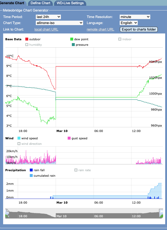

I noticed at 15:35 hrs (UTC+0), that the MB Pro is now working as expected, without any intervention by me since I posted 6 hours ago. My logging screen shows:

Charts show no data from about midnight to about 12:445 (UTC+0) - chart attached. I hope this information is helpful to others.
Re: No data after firmware update
That may be an interest connection issue during startup/reboot?
