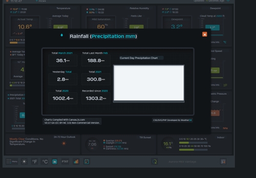

Hello, hoping someone can assist , I have set this template up in wordpress site, the main screen works fine from my nano sd and I have setup the http requests as per instructions but charts appear blank.
Same as all the charts on day/month/year viewer
The files are all in the same folder as index.php

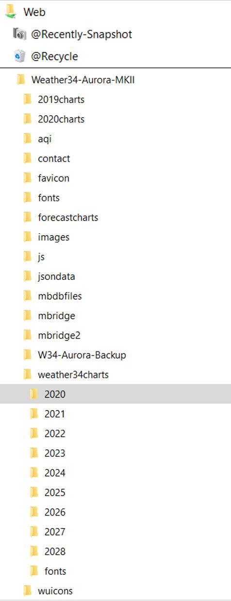

to be sure that we are talking about the same thing, that the definitions are clear (as per Kung Fu Tse 8) ),
find attached a screenshot of the directory structure. The Web root folder is "Web" in my case - that's where everything published by the web server is located. My Weather34-Aurora installation is in a subfolder of web-root, called Weather34-Aurora-MKII
The name doesn't matter, it's your choice - only, later on, it has to be included into the URL - here htttp://domain/Weather34-Aurora-MKII
=> there is no file of the W34 installation which is above /Weather34-Aurora-MKII - only inside and on lower levels.
The directory tree is defined by the zip file.
If you uploaded the whole tree created unzipping the file (including its root) to your web server, it should all work.
Make sure that the URLs for the cronjobs match your directory structure.
And it obviously works to some extent as you can see the current data.
I think, if the structure is correct and the cronjobs are properly set in MB (verify the URL !!), it should all work, also with extra info and almanac.

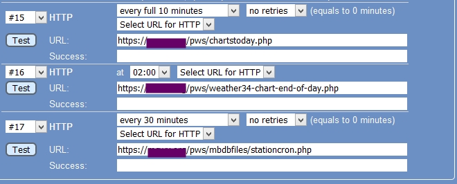

here the cronjobs
What I do in the first line (for my own specific reasons), you may do in the Weather networks tab for W34 (as per official setup guide)

Hi again,
So here is my http requests and yes I use the API under the network tab.
all report as being sent ok.
