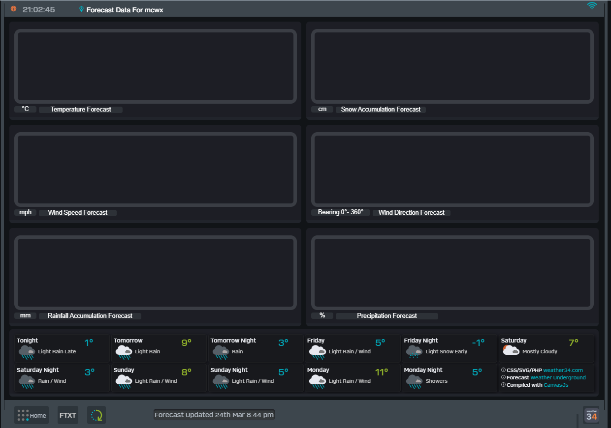

Thank you again for the information , now updated 2021 .
Next issue is the forecast page , I don't get the forecast data populated only the section at the bottom. Checked WU API, all seems good there .
Any ideas ?

Re: Weather34 historic data
I have the same problem, no idea why that is.
But I think you're more likely to get an answer if you ask the question in the right thread.
Sorry its a short reply but thanks it was missing a jQuery string in recent master download only !ToTo wrote: Thu Mar 25, 2021 7:30 pm I have the same problem, no idea why that is.

please run the simple update just uploaded.Should fix the problem.
literally unavailable as of tonight for a few weeks or more so I hope it resolves that issue.
Download Update 25th March 2021
* Fix jquery in chart forecast Ref mcwx1359/Toto (21:38).
Very much appreciated, all working . I have been running the wordpress weather plugin but always wanted to run the weather34, had a few technical issues last year in getting it working (my error) so now a happy chappy.

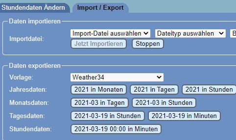

Since I myself had some gaps of CSV data from 2019 to 2021, I made myself an export template for 2019-2020 and 2021. With Weather34 Aurora MKII Version the CSV format was changed a bit, so you need two different templates for the export. As information source which data are written into the CSV files, I took the *chart-end-of-day.php.
The easiest way is to call the export.cgi in the browser, because the Meteobridge interface can export max. 2 years backwards.
To create an entry for each day, the call for 2019 looks like this:
http://meteobridge-IP/cgi-bin/export.cg ... 9_2020.exp
Please check against your own CSV data, if it fits! The values can differ minimally, depending on when chart-end-of-day.php was originally executed. Why in Weather34 Aurora MKII Version is double writing in the 7th and 8th place (Windspeed-AVG) can probably only be answered by developer Brian. I have taken this from weather34-chart-end-of-day.php.
The files must be placed in the meteobridge-IP\data\templates folder.
- data_templates.zip
- (831 Bytes) Downloaded 225 times
