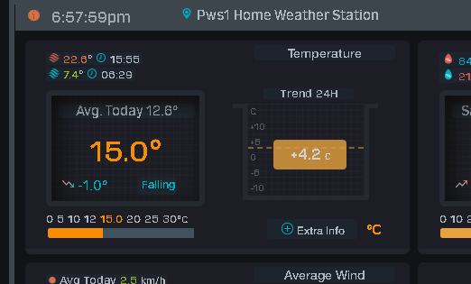

Thanks what I want to know is if the current temperature has increased or decreased since the previous day at the same time, that is, 24 hours before.

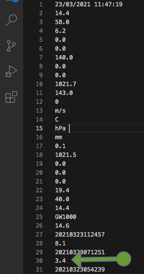

for the output are you using position 30 ?
in your api output you are requesting [th0temp-delta24h:--] twice
1. [th0temp-dmintime:--] [th0temp-delta24h:--] [wind0wind-dmaxtime:--]
2. at the end of API [wind0chill-ymintime:--] [th0temp-delta24h:--] _[forecast-text:]

Thanks Brian for your interest.
https://meteosantgenis.org/pws/mbridge/ ... upload.txt
if I have it duplicated, in position 30 and 196
// $ weather ["temp_24H"] = $ meteobridgeapi [196];
$ weather ["temp_24H"] = $ meteobridgeapi [30];
in case it is a position problem, but it gives the same values. I think the problem is in meteobridge

look carefully at your output the temp24h is the same as the windjmontamat wrote: Tue Mar 23, 2021 1:45 pm No and in barometer It seems that neither, I will keep it under observation.
5.1 20210323054236 3.4
then a few seconds later !!
3.4 20210323054236 3.4
see below output for another change
now this kind of leads me to think are you running multiple api services mistakenly ? to the same file because the value changes in a matter of seconds
then nothing for another minute then 2 short changes in seconds
30 -- * Not Used but you have temp24hdelta assigned
31 [wind0wind-dmaxtime:--]
32 [wind0wind-dmax:--]
at 13:09:01 it showed 3.4 at position 30
23/03/2021 13:09:01 14.6 60.0 6.9 0.0 0.5 90.0 0.0 0.0 1022.0 90.0 1 m/s C hPa mm 0.2 1022.2 7.9 39.6 0.0 19.7 42.0 14.7 GW1000 14.8 20210323123137 8.1 20210323071248 3.4 20210323054236 3.4 ****************
at 13:09:10 it showed 5.3 at position 30
23/03/2021 13:09:10 14.7 60.0 7.0 0.0 0.0 90.0 0.0 0.0 1022.1 90.0 0 m/s C hPa mm 0.2 1022.1 7.9 39.6 0.0 19.7 42.0 14.7 GW1000 14.8 20210323123137 8.1 20210323071248 5.3 20210323054236 3.4 ****************
I used this to monitor https://meteosantgenis.org/pws/mbridge/ ... upload.txt
