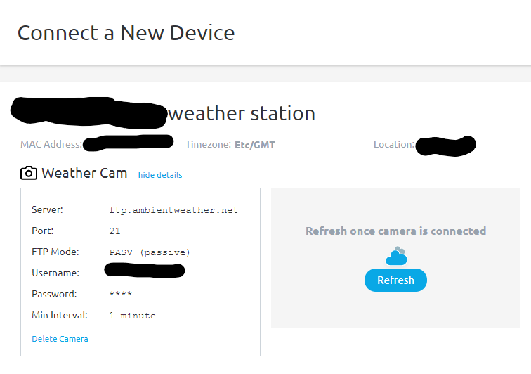

Thanks for the continued help. I updated the FTP string and there appears to be no other connection info on their site. See screen grab as to what is provided. Possibly another forum member here is familiar with how to get this to work.

Re: Add a second FTP/SFTP services configuration in the Services tab
MJM wrote: Fri Apr 02, 2021 11:14 pm Thanks for the continued help. I updated the FTP string and there appears to be no other connection info on their site. See screen grab as to what is provided. Possibly another forum member here is familiar with how to get this to work.
The ftp string needs a base-folder location, which in this case is that /
There should be a name of the uploaded file at the end
Also carefully double check that there is no space between user : password
When I copied the password from the Ambient site it had a space as first character that should not be there.
ftp://USER:PASSWORD@ftp.ambientweather.net:21/cam.jpg
Meteobridge will complain in the "Live Data => Upload Status" tab as it is not allowed to rename the "previous file"
FTP Upload (Camera):
2021-04-03 11:25:35 Error: 2021-04-03 11:25:29 Could not delete old cam.jpg, so could not rename mb_cam.jpg to that: remote delete failed ncftpput cam.jpg: could not rename remote file. (no more tries):
The webcam ftp-server at Ambient is not a "all standars" ftp server and does not allow renames.
If you use a ftp program and upload a file it also "disappeared" when you re-login.
But the file arrives correctly every time Meteobridge uploads.
Could you post a screenshot of what you entered in your Meteobridge for this cam-upload?
Maybe also the error at the "Live Data => Upload Status" tab?

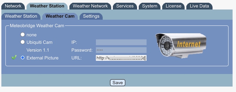

Attached my setup I tested.

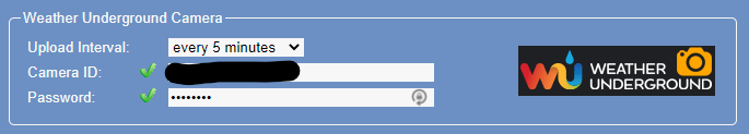

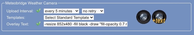

Yes I am uploading successfully to weather underground and Webcam.io. I am using the "Service Setting" tab and FTP/SFTP service settings area for the Webcam.io upload. This is why I originally asked in there was a way to use this settings tab for another webcam upload.

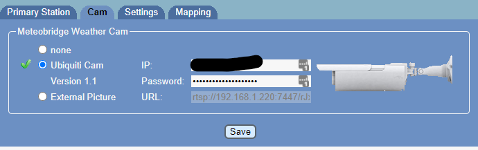

I am using the meteobridge weather cam under the "station" tab to upload to weather underground successfully. See below:
Screenshot meteobridge webcam 2021-04-03.png (23.36 KiB) Viewed 4081 times

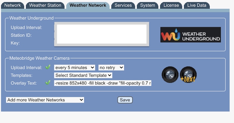

Here is the confirmation under the Weather Nets tab:
MJM wrote: Sun Apr 04, 2021 3:52 am Yes I am uploading successfully to weather underground and Webcam.io. I am using the "Service Setting" tab and FTP/SFTP service settings area for the Webcam.io upload. This is why I originally asked in there was a way to use this settings tab for another webcam upload.
The only difference with my working test-setup:
I upload the image also to the meteobridge (=meteoplug) server, tab "Weather Network" => "Meteobridge WeatherCamera"
You could try to add uploading there also.

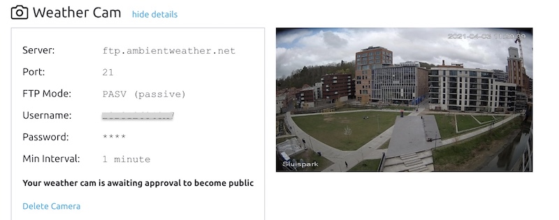

=== If all fails:
There is only one possibility left, a copying error from the Ambient definition.
  • You can delete the camera definition on your Ambient Dashboard.
  • Then define a new camera,
  • copy the values of username and password to a text document ,
    you can only see the pasword once, it is replaced with 4 stars after saving
  • make a screenshot of the definition
and try again to set the upload with those values.
I never uploaded a camera-image to ambient before, I read your request
MJM wrote: Fri Apr 02, 2021 11:14 pm . . .
And I tested it as Ambient users of my PWS_Dashboard also show their webcams on their websites/ambient-net.
It works as it should, just one extra try after removing a space in the copied password.
If it works here at my place, it should work at your site also, no ideas left why it fails, sorry.
