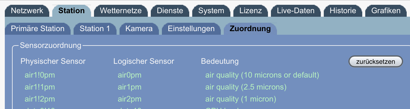

I added my Airlink to the Meteobridge NanoSD setup, just curious as what the "Air" "Air #1" and "Air #2" are relating too?
PM1, PM2.5, and PM10 in that order?
and what do these related to in time?
now, 1hr, 3hr, 24Hr, NowCast?
I cant seem to find any info on these values.
Also is there going to be any support for other country specific AQI's?

For me, this is clearly displayed after including Davis Air:
Davis Airlink Specifications are:
Particulate Matter Sensor
Particle Range of Measurement .............................. 0.3 ̃͂ 1.0 μm; 1.0 ̃͂ 2.5 μm;. 2.5 ̃͂ 10 μm
Particle Resolution .................................................. 1 μg/m3
Accuracy .................................................................. ±10 μg/m3
Update Interval ....................................................... 1 minute
