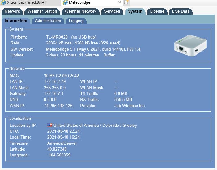

For 5+ years I have had a Davis 6357 connected to a MeteoStick 1.0 and TP-Link Meteobridge (small white box). It has worked flawlessly until a few days ago and now it isn’t showing any raw data or uploading to Wunderground like it used to.
The Davis unit still seems to be sending a signal (blinking green light).
The MeteoStick blinks green.
However, the MeteoBridge configuration software looks different than it used to, and I may not be configuring it correctly.

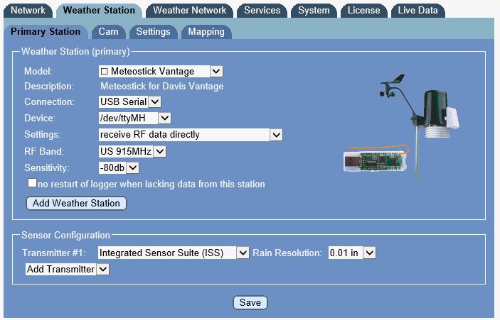

For the “Primary Station” do I choose “Vantage” or “MeteoStick Vantage”?
Has something changed with recent firmware/software updates?
Any help would be appreciated. This has worked wonderfully for years.
Thank you!
Meteobridge info 5-10-21.JPG (65.68 KiB) Viewed 1792 times

Since you now have the most recent version of the Meteobridge Software dated May 6 and that seems to be when you started having problems I suggest reverting to an earlier version of the Meteobridge software that you know was working and see if that solves the issue. If so you know there’s a bug in the most current release as it pertains to your setup.
You should choose "Meteostick Vantage" as that is what you use.
The other choice is used for Davis VP stations with a logger .

Thank you for your responses! I did revert back to 5.0, but then also noticed that setting up the station is now a two-part step with the newer UI in Meteobridge (there used to be one long page with various checkmarks and boxes to fill).
It seems to be working, but since I didn't check the software change by itself, I'm not certain if it was that or my Station configuration. In any case, thank you for replying. I really appreciate it. Here is what my Station configuration now looks like:
now it's working!
now it's working!
Meteobridge info 5-10-21 (started working after reconfig).JPG (58.21 KiB) Viewed 1760 times
