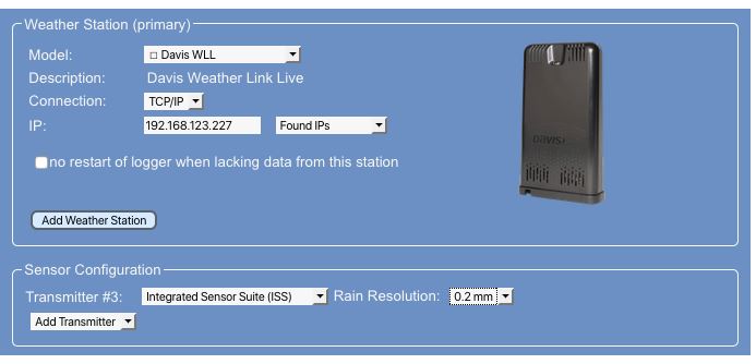

I have installed a weatherlink live. I use no Wifi but a utp connection with a fixed ipdres.
My weatherstation:
- VP2+ (#7)
- seperate wind anemometer (#8)
The sample in the Wiki shows an extra sensor configuration? I have to do that also?
And my anemometer?
Posts: 1486
Re: Weatherlink live configuration
That image is only an example with an ISS on Tx#3
Appears your ISS is Tx#7 and Tx#8 would be a Wind Station in the sensor configuration

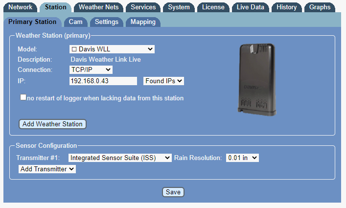

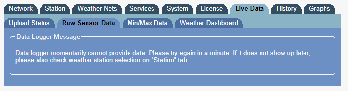

I changed my Davis VP2 from Wifilogger to Weatherlink Live.
WFL was running on my MB, but now the WLL is not working:
WLL IP is right and fixed. Did I miss anything in configuration?
