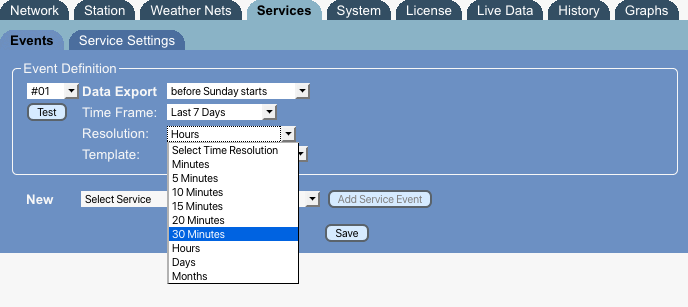

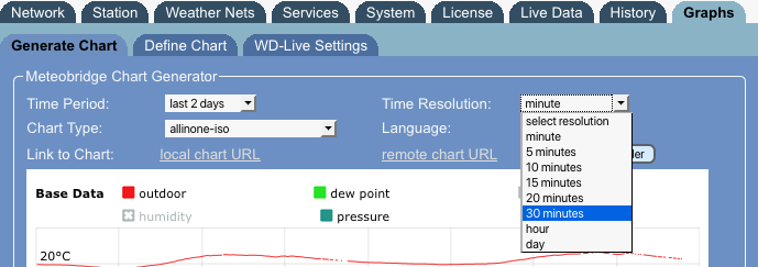

Added time resolution 5/10/15/20/30 minutes for exports and graphs
With just released version 5.2 Meteobridge allows for exports and graphs on a time resolution of 5/10/15/20/30 minutes. This has often be requested as a resolution of 1 minute provides too much data and having it just every hour seemed some as too coarse. To have the new time resolutions working Meteobridge must operate in "per-minute storage" mode, which can be selected on "System - Administration" tab.
When selecting time periods and time resolutions for exports and graphs please keep in mind, that a combinations like a period of the full year in 5 minute resolution are not provided because it would result in too much data.

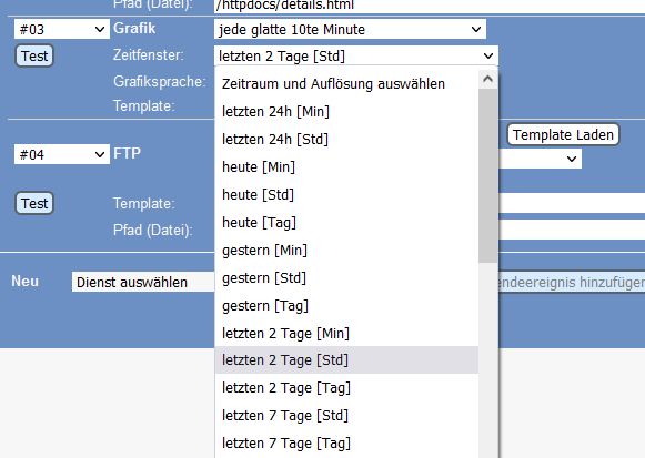

Stebi
Posts: 18
Joined: Mon Jul 12, 2010 7:47 pm
Location: Basel, Switzerland
Re: Added time resolution 5/10/15/20/30 minutes for exports and graphs
Post by Stebi »
Hi there
it would be nice to have a higer time resolution for "Events->Zeitfenster" also.
15 minutes would be enough for my purposes.
Thomas
Just released update gives a bit more flexibility on definition of time frames and resolution.
From the release notes May 1, 2022:
Meteobridge PRO, NANO SD, RPI: adds more flexibility to automated chart generation. Beside pre-defined time frames there is an option "user defined" added, that allows to define the start and stop time freely. Definition is done relative to the point in time when the event gets triggered. Syntax is the same as when calling a chart generation via URL parameters. Start and stop times are specified like "Yn" (year), "Mn" (month), "Wn" (week), "Dn" (day), "Hn" (hour), where the first letter indicates the time scale (year, month, week, day, hour) and the consecutive number indicates how many steps to go into the past. Example: "from:H6 to:H0" indicates a period from 6 hours in the past (H6) to the current hour (H0). Time resolution can also be specified from minutes to months. There are no plausibility checks, so you are responsible not to select too large data volumes or invalid time period definitions.
