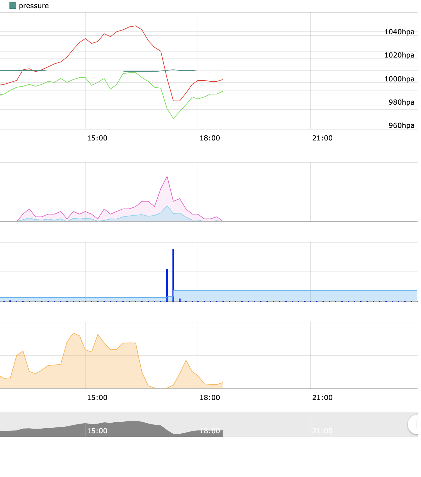

There seems to be a bug in the latest update: In all charts the line for accumulated precip is too long and does not stop at the same time as the other parameters. See attached image:
Bildschirmfoto 2021-07-25 um 18.45.25.png (145.93 KiB) Viewed 2585 times

Should be fixed with newest update.

admin wrote: Thu Jul 29, 2021 9:17 am Should be fixed with newest update.
Seems to be fixed with all the "predefined" charts, however, I still have this bug in the self-defined graphs

I think Neco meant this problem.
With a resolution of 1 minute everything is OK
https://admin.meteobridge.com/91ee98fbb ... 2108080030
With a resolution of 5 minutes, I only have a rain total for the day of 1.6mm
But for me this is the case with all cumulative sensors

First, I think there is a slight misconception in your example. "rain0total" is the amount of rainfall in a given time period. In your example you name "rain0total" as "Regen/min". IMHO this is wrong as it is the total in a time frame that is defined when calling the graph. It can be 1min, 5min, 1hour, etc. I would call it "Regenmenge".
Putting that aside it is indeed strange that "rain0total-daysum" does show differences if you take per minute or 5 minute resolution. I inspected this in more detail and found a bug in the code. Please give just released version a try.
Does this also fix the bug mentioned in the beginning of this thread?
Re: Bug in Precipitation Graphic
Just released update should also stop dailysum evaluation when no new data there.

Yes, the name was a bit unfortunate. Thanks for the correction
The evaluation of "rain0total" works correctly after the update.
