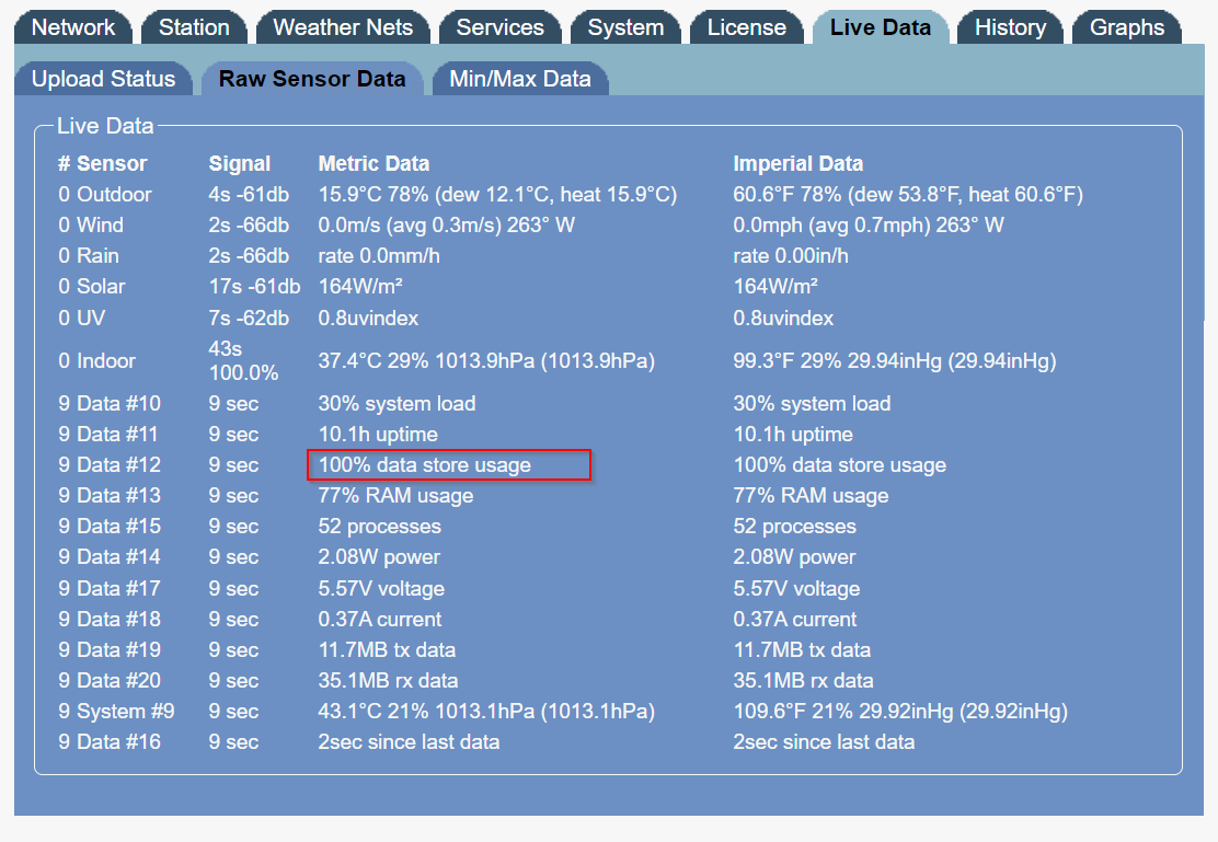

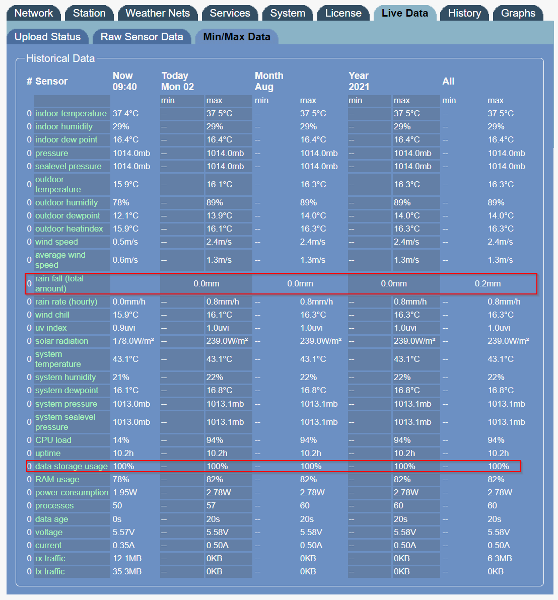

Hello experts,
I noticed that my website (Meteotemplate) shows implausible rain data. This can also be seen under "Live-Data".
Min Max Data 20210802-094204.png (189.44 KiB) Viewed 2443 times

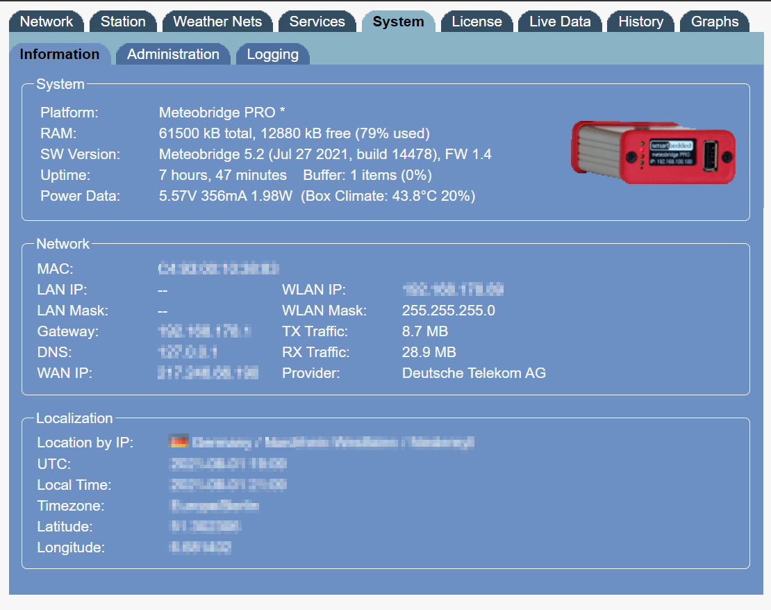

System 20210801-211043.png (127.96 KiB) Viewed 2443 times

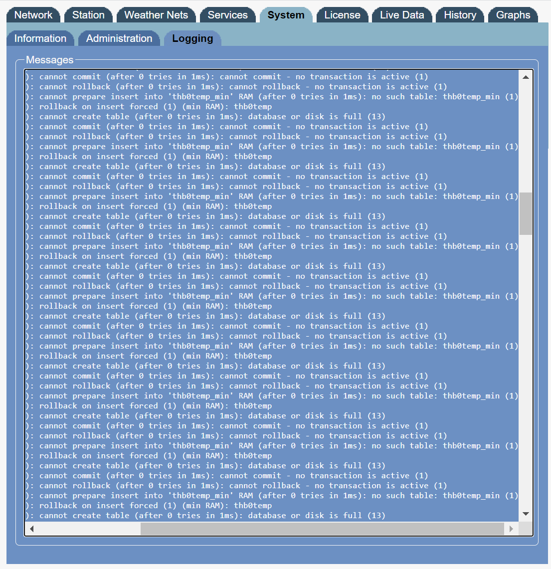

In the logging page you can see messages that the "100% data store usage" is the reason and that other sensors cannot work properly either.
Log 20210802-094549.png (217 KiB) Viewed 2443 times

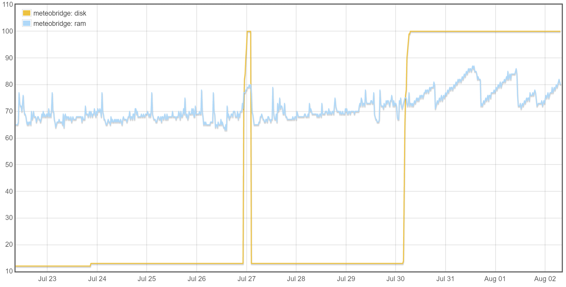

I am constantly sending health data to another IT system and there I see that one day the memory is suddenly from 13% to 100% full. Shortly before that, this was the case for a short time. What happened? I have set MB so that the latest version is always installed on a reboot.
health data 20210802-093654.png (219.62 KiB) Viewed 2443 times

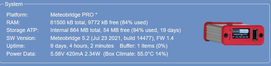

I've restarted MB a few times in the last few days, maybe it was the 5.2 update? Switching back to version 5.1 didn't solve the problem.
It can't be the database with the weather data. Who has an idea who is using the memory?

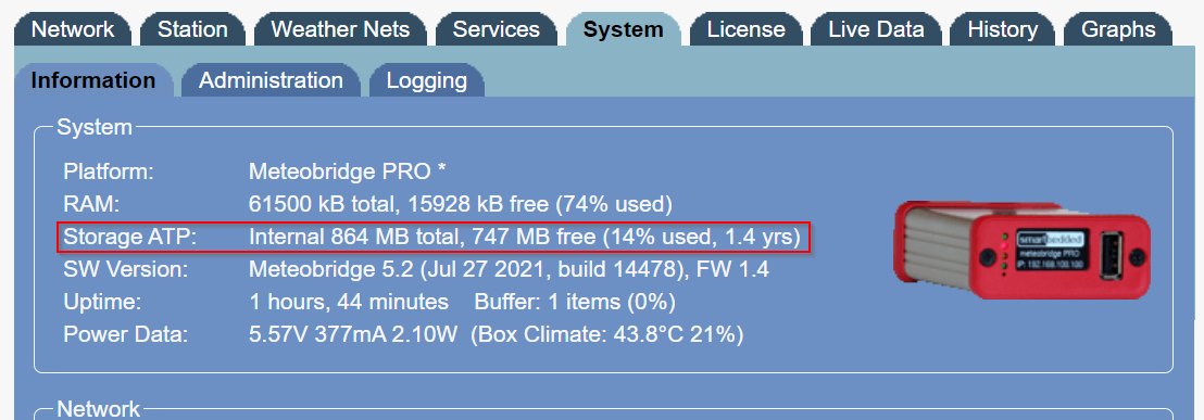

the System info should have a line which says
storage ATP: ................ that would be the internal flash memory
It doesn't show in your case -hence no internal storage mounted ...
and the database size is 0 (then the message in the system log is correct, DBsize 0 and no storage space
If after a power cycle (=shutdown, switch on again and start again with option "get newest on reboot" active in version control (system - administration - save and apply) (select before shutdown :wink: ), nothing changes in the system information view, I'd say the device is defective.

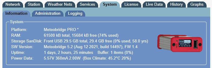

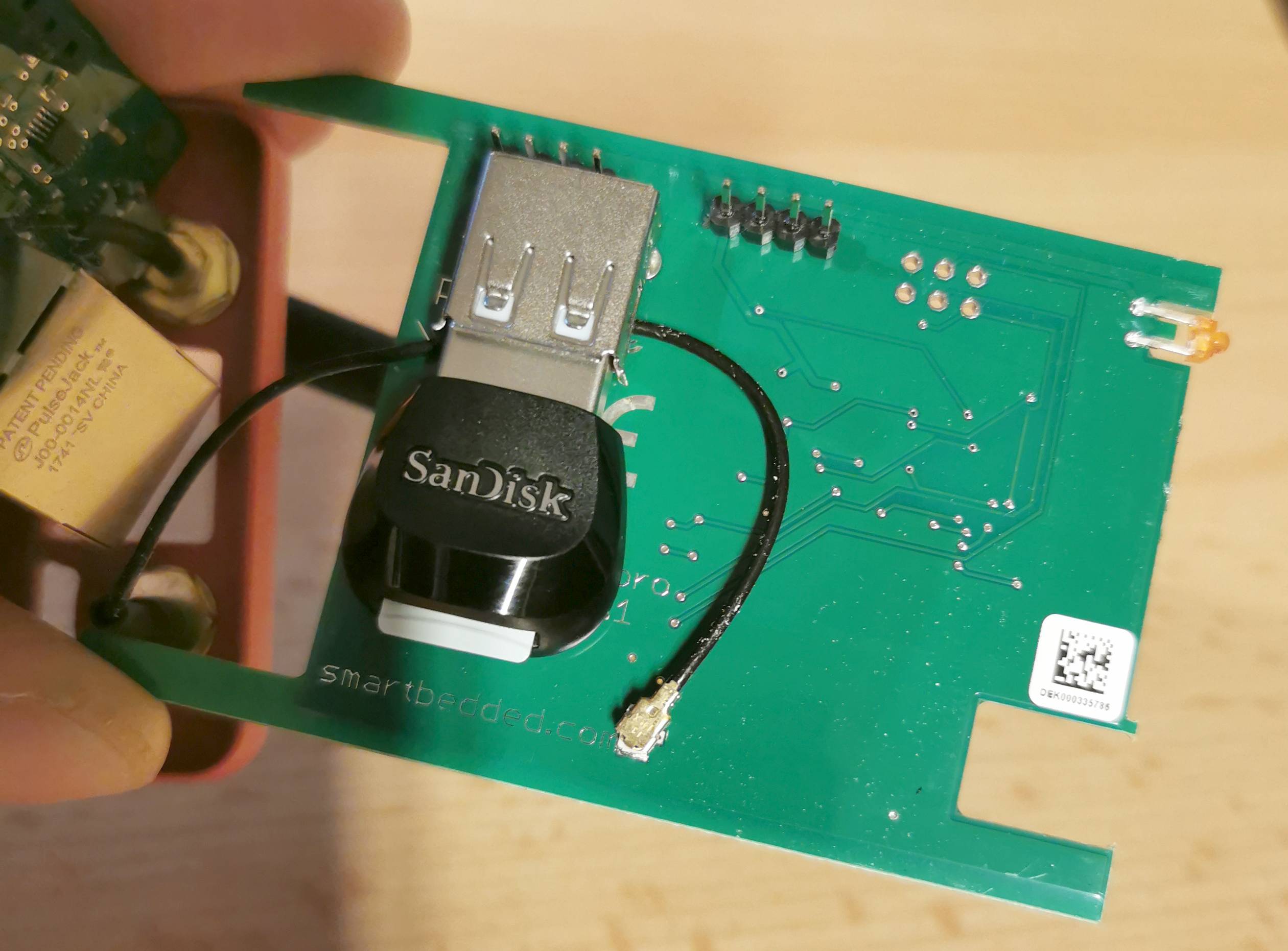

My meteoBridge PRO red is from November 2019. I have a SanDisk 16GB USB stick in the front for data backups.
I did it as suggested. At first it was unsuccessful. Then I disconnected the power supply for 1h and restarted. The Storage ATP is now visible again.
Is it maybe a hardware error that has to do with the temperature in the case?
This is what it looks like in the file system:

Today I waited to see if everything worked again. In the meantime, during the analysis, it was not possible to write to the database, only read it. I've tried a few things, but it's still buggy.
After about 4 hours the Storage ATP has disappeared again. If I switch it off with “Power Off” and switch it on again, the Storage ATP appears again. But not after a “reboot”.
Is the database now defective and causing further errors? Since the MB has now run with the error for a few days, plausible entries are missing in the database. Is there a way to repair it automatically?
When I try to restore a backup (with option "Delete database before restore"), the memory disappears again and there is an error:

database (04.08.2021 00:08:42): rollback on insert forced (1) (storemin): data20num
database (04.08.2021 00:08:42): cannot insert into 'data20num_min'  (after 0 tries in 1ms): attempt to write a readonly database (8)
database (04.08.2021 00:08:43): cannot insert into 'data20num_min'  (after 0 tries in 1ms): attempt to write a readonly database (8)
database (04.08.2021 00:08:43): rollback on insert forced (1) (storemin): data20num
database (04.08.2021 00:08:44): cannot insert into 'data20num_min'  (after 0 tries in 1ms): attempt to write a readonly database (8)
database (04.08.2021 00:08:44): rollback on insert forced (1) (storemin): data20num
database (04.08.2021 00:08:45): cannot insert into 'data20num_min'  (after 0 tries in 1ms): attempt to write a readonly database (8)
database (04.08.2021 00:08:45): rollback on insert forced (1) (storemin): data20num
database (04.08.2021 00:08:45): cannot insert into 'data20num_min'  (after 0 tries in 21ms): attempt to write a readonly database (8)
database (04.08.2021 00:08:46): cannot insert into 'data20num_min'  (after 0 tries in 1ms): attempt to write a readonly database (8)
database (04.08.2021 00:08:46): rollback on insert forced (1) (storemin): data20num
database (04.08.2021 00:09:00): cannot insert into 'rain0rate_min'  (after 0 tries in 1ms): attempt to write a readonly database (8)
database (04.08.2021 00:09:00): rollback on insert forced (1) (storemin): rain0rate
database (04.08.2021 00:09:01): cannot insert into 'rain0rate_min'  (after 0 tries in 1ms): attempt to write a readonly database (8)
database (04.08.2021 00:09:01): rollback on insert forced (1) (storemin): rain0rate
database (04.08.2021 00:09:02): cannot insert into 'rain0rate_min'  (after 0 tries in 1ms): attempt to write a readonly database (8)
database (04.08.2021 00:09:02): rollback on insert forced (1) (storemin): rain0rate
database (04.08.2021 00:09:03): cannot insert into 'rain0rate_min'  (after 0 tries in 1ms): attempt to write a readonly database (8)
database (04.08.2021 00:09:03): rollback on insert forced (1) (storemin): rain0rate
database (04.08.2021 00:09:04): cannot insert into 'rain0rate_min'  (after 0 tries in 1ms): attempt to write a readonly database (8)
database (04.08.2021 00:09:04): rollback on insert forced (1) (storemin): rain0rate
database (04.08.2021 00:09:05): cannot insert into 'rain0rate_min'  (after 0 tries in 1ms): attempt to write a readonly database (8)
database (04.08.2021 00:09:05): rollback on insert forced (1) (storemin): rain0rate

It took me a few days, now I can report what I did.
The analysis has shown that the built-in USB stick (an ATP Nano Dura SLC 1GB USB stick) repeatedly fails sporadically. Sometimes it works and then fails and works again, it breaks the operating system and the database.
That made it so difficult to solve, a total failure would have been easier :-)
I wanted to replace it, which in principle also worked. But I noticed how warm the memory in the device gets and decided to only use the external USB ports.
At the front I use the connection for the database and at the back for the automatic backups.
Since I didn't get an SLC USB stick so quickly, I now use two SanDisk MobileMates with a SanDisk MAX ENDURANCE microSD card. Thanks for the tip, I didn't know this type of SandDisk yet.
MB Pro USB Intern.jpg (293.63 KiB) Viewed 2229 times
This combination even fits into the housing. But I noticed how hot it gets in operation and have now only installed everything on the outside. The slot inside now remains free and the CPU in the case may be colder. If there are problems I can change the memory so quickly. Currently the memory is sufficient for 58 years :-)
The tips should make it easy to restore the old backup. But it didn't work as easily as described. I always had the problem that the old data was not imported, I didn't know why?
Working and copying through the SSH terminal was also a solution, but the database kept producing errors and not working properly.
I set everything up again 100% without old data and probably got the old data back in with a trick.
I would like to see a few new functions for these cases.

Rennpferd wrote: Tue Aug 17, 2021 1:47 pm It took me a few days, now I can report what I did.
a) Did you try to contact Smartbedded on that ? They might replace the internal USB - even the whole maiboard:
info@smartbedded.com
b) the MB Pro can get pretty warm not to say hot - mine gets up to 50°C - I put the case on an old 3.5" HDD which serves as a heat conductor - that reduces the temperature quite well.
I wouldn't care too much about heat with a proper passive cooling equipment in place(like my "re-purposed" old HDD)
