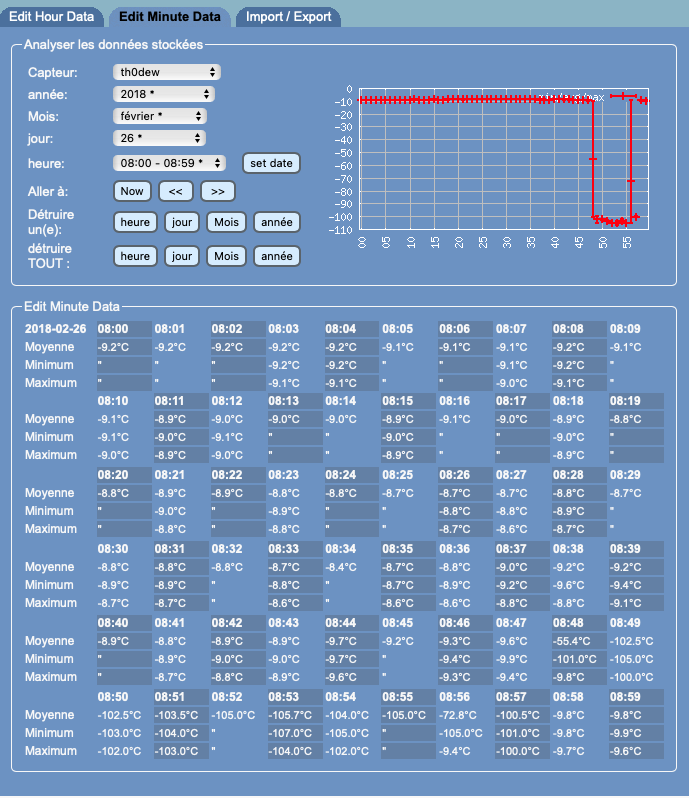

looks like we have an issue with the import filter
I've imported a bunch of RAW meteohub (coming from a vantage pro2) data
I see some spike with Dewpoint external temp (th0)
original raw
20180226074851 th0 -23 55 -101
-23 means -2.3 °C for temp
55 means 55% humidity
-101 means -10.1 °C for dew temp
the imported dew temp value peak to -100°C when the original dew temp is <= -10°C
here is the extract of meteohub documentation, looks like the digit change
for th#
temperature [1/10 °C]
humidity (0-100) [%]
dew point [°C] (or 1/10 °C when number has leading 0)

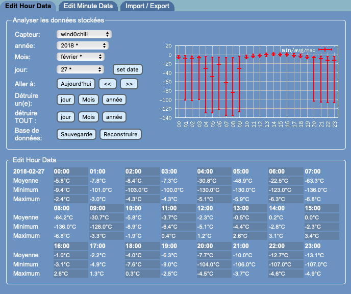

I'm continuing investigation. Windchill looks the same
wind direction (0-355)
gust speed (0-...) [1/10 m/s]
average speed (0-...) [1/10 m/s]
windchill [°C] (or 1/10 °C when number has leading 0)

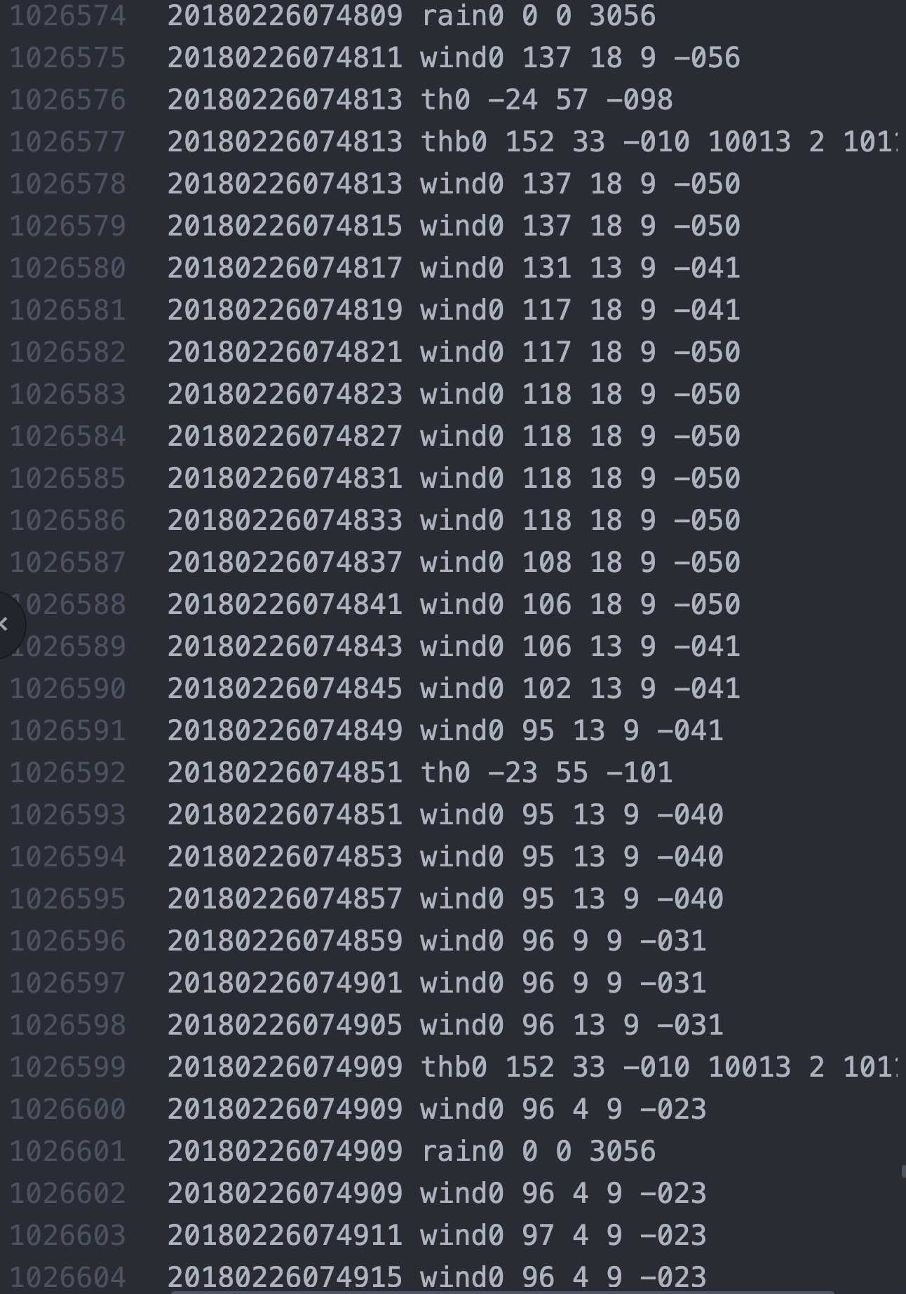

Re: RPI: issue during import meteohub data
ok
for a reason I ignore, my initial meteohub raw data are not well formed:
-when the temp is below -10°. the 0 is not appended at the beginning, it should be as it's a xx,x value
looks like the issue is from meteohub
if someone have a solution, I will take it.
I'm thinking about a Regex...
ok, I've managed to fix the issue which was generated by meteohub
to recap
the leading 0 was missing for value when temperature <=10 °C
here is a sample
it should be 20180226074851 th0 -23 55 -0101
so I've made 2 pass with sed command
sed 's/\(-1[0-9][0-9]\)/-0\1/g' original_raw > modify_raw_pass1
it search for -1xx value and append -0 to it
sed 's/-0-/-0/' modify_raw_pass1 > modify_raw_pass2
it replace -0- by -0
I will now double check if my data are fine
to recap
here is a sample
