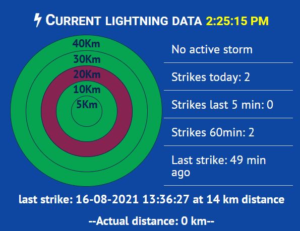

I tried to post the last lightning occurrence date/time stamp, but didn't succeed.
lgt0total and lgt0dist are showing their proper values
[lgt0total-nonzerotime:--] just produces "--" and [lgt0total-nonzerotime] produces "[lgt0total-nonzerotime]" - the text between the "",
but no date/time stamp, neither in EPOCH format nor in the promised format as per WiKi
" nonzerotime: timestamp of last occurrence of a nonzero value
Timestamps are strings of format "YYYYMMDDhhmmss". Year "YYYY" is reported in 4 digits, all other values (month "MM", day "DD", hour "hh", minute "mm", second "ss") come with 2 digits, leading zeros are not suppressed. "
I'm using the latest built from 15-Aug-2021 and am also just after a lightning strike....
[lgt0total-dmaxtime=epoch] works, but this is only for today ....
as this works, it's unlikely to be a mapping issue.
Any thoughts ??

was a stupid typo, had written "nozerotime" instead of "nonzerotime" in the API string :roll:
But showing that it works - the WiKi says "should" - is also a good experience
