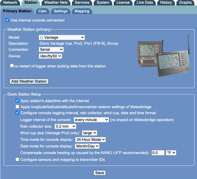

Davis just told me how to set on console, which isn't what NanoSD is attached to.
My NanoSD is in an Envoy... could the Envoy be set to Metric somehow? Would the NanoSD not be setting that on there? How would I change that? Hook up a Weatherlink USB adapter and change it then put the NanoSD back in? Or should the NanoSD be able to write that to the Envoy?
Re: WL Cloud Rainfall Conversions
NANO can change the rain bucket size in the Vantage. This is controlled on "Station" tab, where you can select "rain collector size" options.
Bildschirmfoto 2022-01-08 um 17.55.59.png (148.8 KiB) Viewed 3611 times
After having pressed "save" please check in "system - log files" tab the settings have been applied. There will be an error message, if it failed.

that box was unchecked, but when checking, already was set to 0.01inch.
Clicked save, this is what I got:

fwiw, box is unchecked again... so must just be a one-time setting, or should the box remain checked after hitting save?

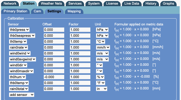

Check the Weather Station>Settings tab and check if rainototal is listed in the installed Sensor list? If not then add sensor from the drop down list and also check Unit settings (mm or in).
staze
Posts: 201
Post by staze »
it was indeed missing until I really started trying to figure this out a couple weeks ago, when I added it. Info is still wrong in WeatherLink.
But I just noticed something... see screenshot. The heck? I've changed them to be imperial units... guess we'll see.
