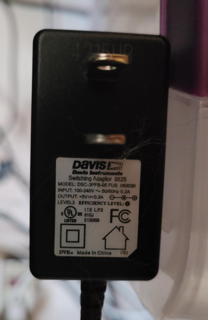

Looks like a too weak power supply.
wilkerjnc
Posts: 29
Joined: Mon Jan 25, 2021 4:22 am
Re: NanoSD Continually Reboots
Post by wilkerjnc »
My power supply is the original Davis one as seen in the pic:
Switching Adapter 6625
Model: DSC-3PFB-05 FUS
Output: +5v 0.3A
Is the an indicators in any log on the NanoSD itself that could help verify this?
What is the recommended power output for an external power supply?
Please try an 1A option.
Please read here: viewtopic.php?f=56&t=13795

OK I installed 1 of these today:
https://www.amazon.com/dp/B015PXUHYA?ps ... ct_details
Universal AC Adapter, ZOZO 12W 3V 4.5V 5V 6V 7.5V 9V 12V Regulated Multi Voltage Switching Replacement Power Supply for Household Electronics Routers Speakers CCTV Cameras Smart Phone USB
2A on the 5V line.
Lets see how that goes...
