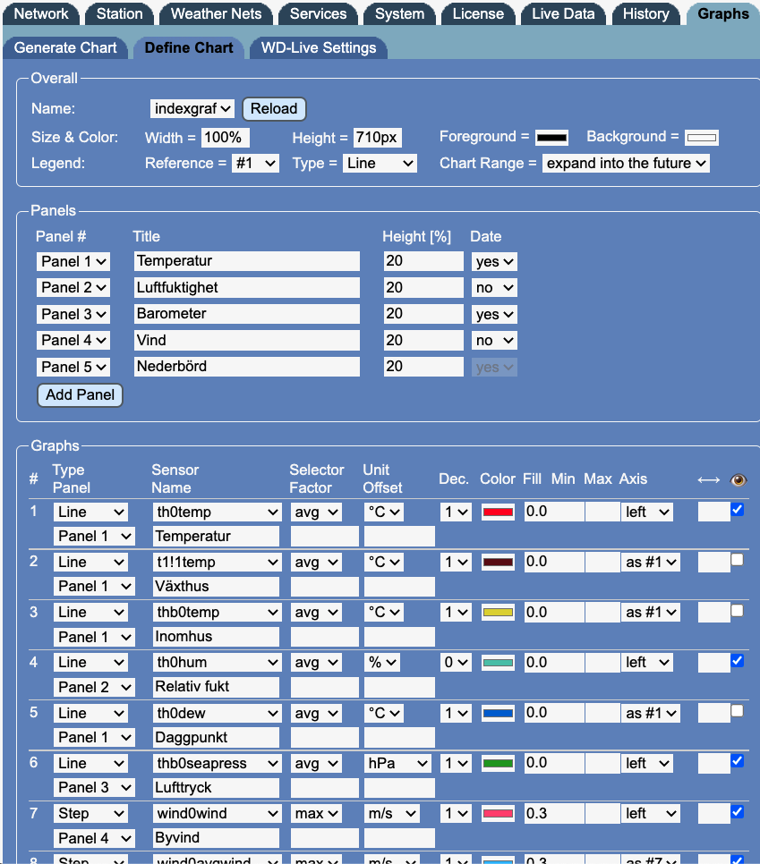

NOTE! Another option is to use the metachart option in the meteobridge. With that you can make the layout and contents of the graph the way you want. (See attached screenshot) The name you enter at the top, you then choose as template in the settings->events.
