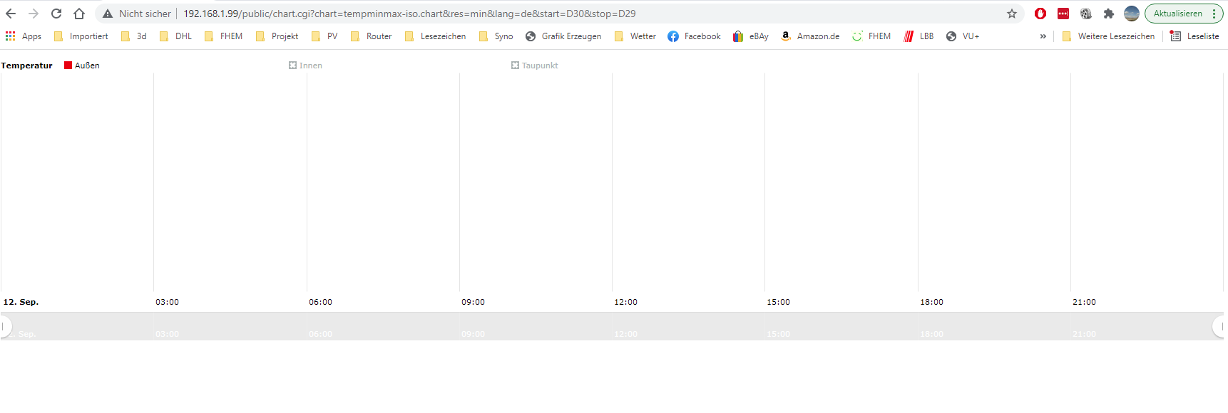

Hi there,
I'm switching from Meteohub to Meteobridge Pro. Now there is the problem that the imported raw data is not processed correctly by Metohub.
Under hourly data are e.g. from 9/12 all data of the sensor th0temp is available, but as soon as I have a diagram of the sensor th0temp on 9/12. would like to generate this remains empty.
greeting
Thorsten Meissner
Re: Import of Meteohub raw data
As no data edit tab for minute data is shown below "History" tab, you have not selected per minute permanent data logging.
Therefore, the graph you requested in time resolution "min" does not find any per minute data.
When you change the resolution in the graph calling URL to "hour", data will show up.

hello, thank you very much. That was the solution, when I go to the hour the dates are displayed….
