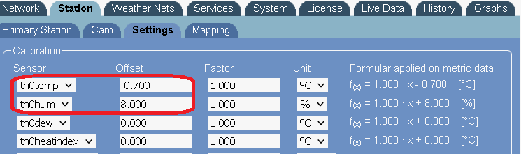

The calibration in the meteostick is Temp. = - 0.7 and Hum. = 8% (image1)

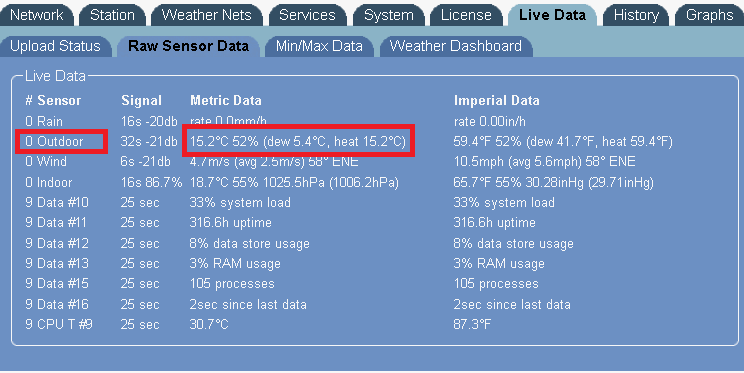

With Output Temp. = 15.2 and Hum. = 52% the correct values are
Dewpoint = 5.4 and heatindex = 15.2 (image2)

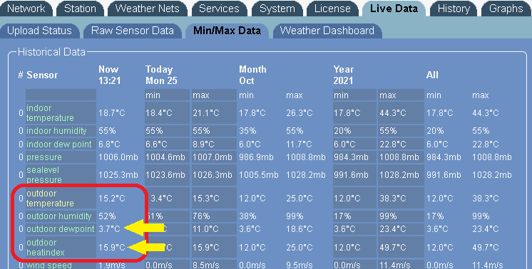

But meteostick sends prices to ALL networks
Dewpoint = 3.7 and heatindex = 15.9 (image3) which is wrong!
Re: Problems with the Meteostick!
it is a not related to Meteohub but to Meteobridge. Issue has been resolved by latest updates.
