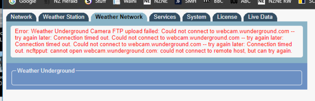

This is the response to accessing the Weather Network tab sometimes...
Screenshot 2021-10-24 170106.png (139.73 KiB) Viewed 3414 times

Logged into my Weather Underground account!
Webcam hosting service is discontinued effective October 21, 2021
Weather Underground will discontinue the webcam hosting service effective October 21, 2021 in order to better focus on the core products that make Weather Underground one of the best destinations for weather enthusiasts. Only the webcam service is being removed. Our network of weather stations, as well as the web site and mobile apps will continue to provide you with the information you love. Webcam data will be deleted from our servers on or after this date.
We have spent significant time and energy to update our forecasts and Personal Weather Station (PWS) Network over the past several years. When we looked at taking a similar path forward for the webcams, it became clear that an upgrade to modern technologies would be incompatible with many of the cameras currently using our platform. We decided that the investment required to start the network over from scratch would not be viable. Our efforts will instead focus on the performance, stability, and vitality of our core offerings. Please rest assured that the PWS Network remains a core piece of Weather Underground.
Too much of a coincidence for me.
I think we need a new Meteobridge version that drops support for wunderground webcams and ignores any config data. It's going to keep trying for a long time.

Is this likely to be causing MB to stall on a timeout and exhibit the issues I am seeing, or do I have some other issue?

I’ve deleted the camera entry from the weather station tab and rebooted. Now the upload status page says “no weather network traffic” against the WUC entry. I.e. no errors.
But I still can’t access the Weather Network tab to delete the entry or modify anything else. All I get back is “the cgi process did not produce any response”.
