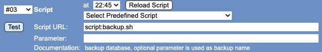

Backup is done by disabling the database and doing a low level data copy. Therefore, there is no database access for exports, charting etc during that period of time. Your idea of keeping backup times away from export/chart generation times is right. You can give the backup a specific time, when to run each day. This should resolve the issue.
Bildschirmfoto 2021-11-14 um 11.26.57.png (23.29 KiB) Viewed 997 times
