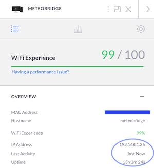

Re: Nano not reachable some time after (re)boot
Happy to do so but I can see that it is still active on that ipaddress.
