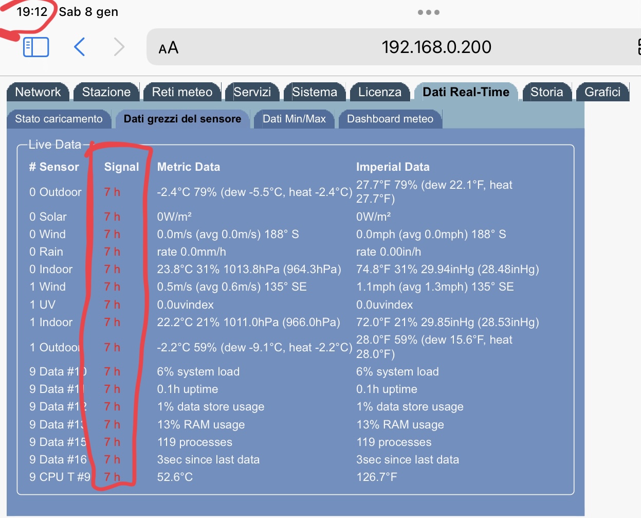

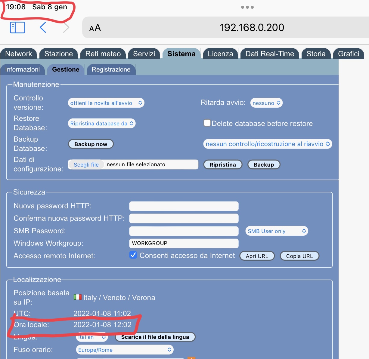

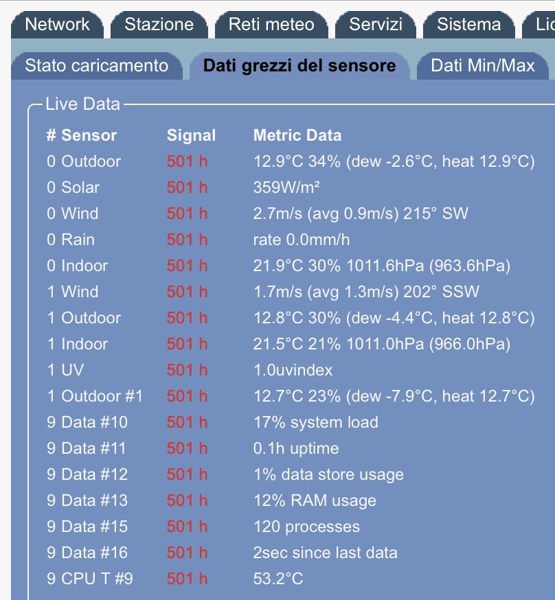

Good evening.
Every time I switch on or restart the meteobridge, for a few minutes is indicated the time of the last switch on instead of the current time.
After a few minutes, the time is updated but data is no longer received from the station.
I attach photos.
I have a meteobridge installed on Raspberry Pi 3 Model B +.
How can this be solved?

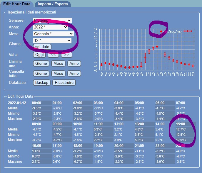

Post by lorenz1982 »
Today I rebooted to install the update and the date went back to January 12, 2022.
Immagine 2022-02-02 141130.jpg (116.24 KiB) Viewed 1647 times
MeteoBorgo: www.meteoborgo.it
Re: Wrong system time
I don't understand why a very few systems are having this issues while others don't.
Can you please give me remote login so that I can dig a bit deeper?
Please send credentials to "info(at)meteobridge.com".
I think this is solved with latest release. If not, please repost.
