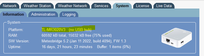

On a V1 MR3020 the reason would be obvious, the missing USB hub. V3 has another SOC which does not have the USB 2 issue. Are you sure it is a V3?

This is my Hardware Platform.
