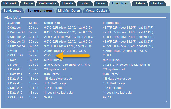

i use actual a RPI with my weather Station TFA Nexus, all so works fine, but one not
i get no windchill by meteobridge.
As Windchill i get a "0 CPU T #9" ( see attached Picture )
any one a idea whats wrong ??
Thanks for your help in advance
Klaus
PS: RPI up to date :) its a Pi 3 B+
Re: Meteobridge RPI and TFA Nexus
Temp sensor on channel 9 is thought to be CPU temp by the dashboard. But this is just how the dashboard interprets this.
You can map "th0:9temp" to logical sensor "wind0chill" on "station - mapping" tab when you want the weather networks to operate with this as windchill.
