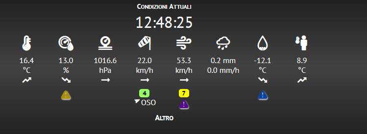

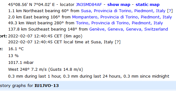

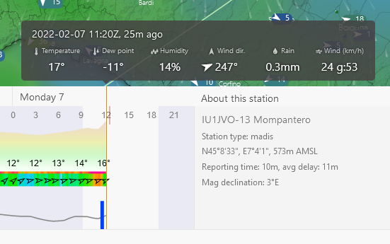

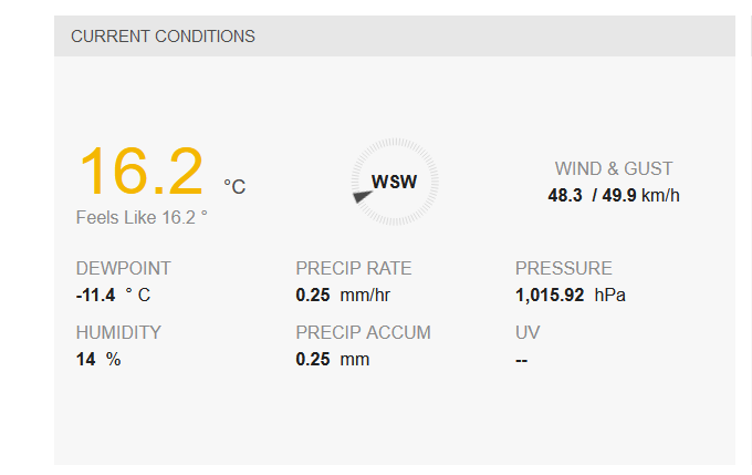

Looking at the wind data for my station on Weather Underground and comparing it with other networks (windy and APRS), I find discrepant values.
On Weather Underground seem to be used only Gust values and not the average speed value.
I don't understand if this is a problem of weather underground or related to the data sent from meteobridge.
Weater Underground:
Windy:
APRS:
My Meteotemplate:

Issue resolved disabling the Weather Underground wheather network and implementing a HTTP Upload Event using the following URL:
https://weatherstation.wunderground.com/weatherstation/updateweatherstation.php?ID=IMOMPA3&PASSWORD=zru8qTOV&dateutc=now&winddir=[wind0dir-act]&windspeedmph=[wind0avgwind-act=mph.2]&windgustmph=[wind0wind-act=mph.2]&humidity=[th0hum-act]&tempf=[th0temp-act=F.2]&rainin=[rain0rate-act=in.2]&dailyrainin=[rain0total-sumday=in.2]&baromin=[thb0seapress-act=inHg.2]&dewptf=[th0dew-act=F.2]&softwaretype=meteobridge&action=updateraw

Using the "standard" Weather network for "Weather Underground", Wind speed and Wind Gust were de same.
this is (I suppose) caused by my virtual weather station that compute and return as wind speed the wind "gust" in the past 10 minutes and as average the "wind average speed the past 10 minutes average.
I don't know why other "standard" weather network does not have the same issue and display the wind speed (end gust speed) well.
But using the above string to send data to to weather underground, speed and gust is showed well also on WU.
