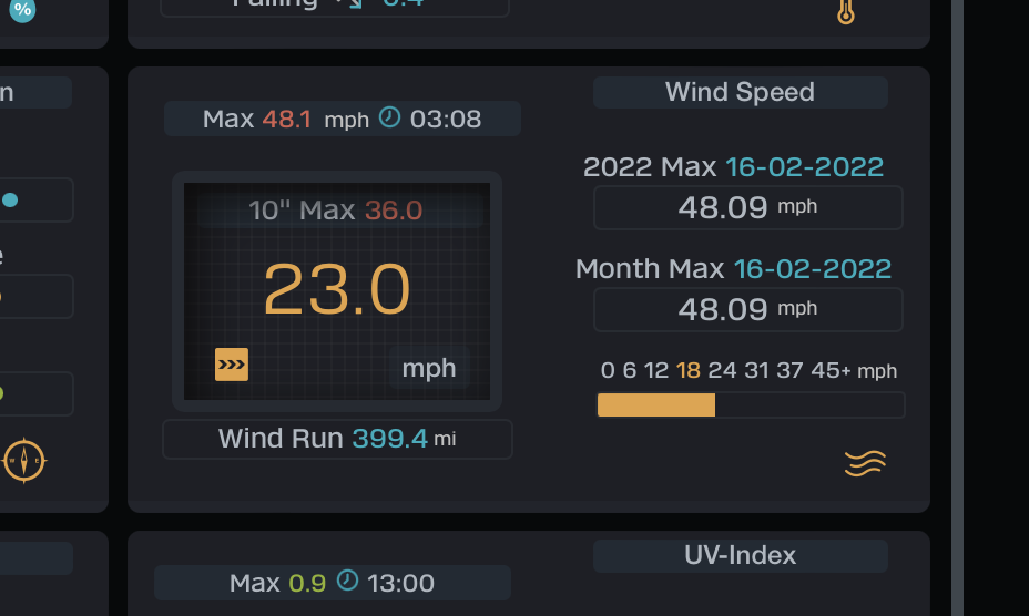

Every day thee Weather34 and original templates record a maximum wind gust. The time of the gust is never updated on the dashboards. I have emailed the original Weather34 dashboard developer (Brian) who has retired from development and he was kind enough to say that this comes from MBREALTIMEUPLOAD.txt generated by the NANO.

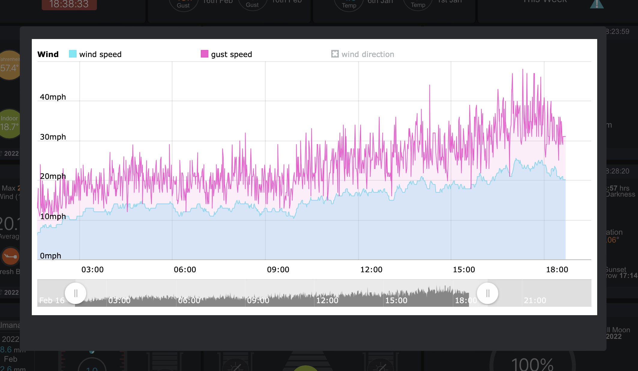

Would anyone be able to help resolve this, two images showing a daily graph and non-updated template time are attached. The time stamp for a gust at 3:08am is well below gusts later in the day.

Looking at the graph the peak gust seems to be ~17:00. The Max gust time on the template is showing as 03:08. As the template gets all it data from the Meteobridge NanoSD then it can only be a timezone setting thats different between the Meteobridge NanoSD and the template.
You'll have to look at your Weather34 template console settings to see what timezone is set and check that against the NanoSD.

Thanks for the reply. It was during a particularly gusty UK day, the anemometer is very exposed. The timezones on both match and once one gust is recorded the gust time never changes.
