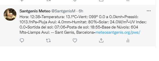

Would there be the possibility of adding the webcam to the twitter post service like this?

I am currently using this template:
Hora: [hh]:[mm]•Temperatura: [th0temp-act:--]°C•Vent: [wind0dir-avg10.000:--]° [wind0wind-act=kmh.1:--] a [wind0wind-max10=kmh.1:--]kmh•Pressió: [thb0seapress-act.1:--]hPa•Pluja Avui: [rain0total-sumday]mm•Humitat: [th0hum-act.0=:--]%•Solar: [sol0rad-act:--]W/m²•UV Index: [uv0index-act:--]•Sortida del sol: [mbsystem-sunrise:--]•Posta de sol: [mbsystem-sunset:--]•Base de Núvols: #if#[th0temp-act.1:0.0]>[th0dew-act.1:0.0]#then#{*((([th0temp-act.1:0.0]-[th0dew-act.1:0.0])*400)*0.3048)+250*0}#else#0#fi# Mts•Llamps Avui: [lgt0total-daysum.0:--] Sant Genis, Barcelona•https://meteosantgenis.org/pws/ - Attachments
