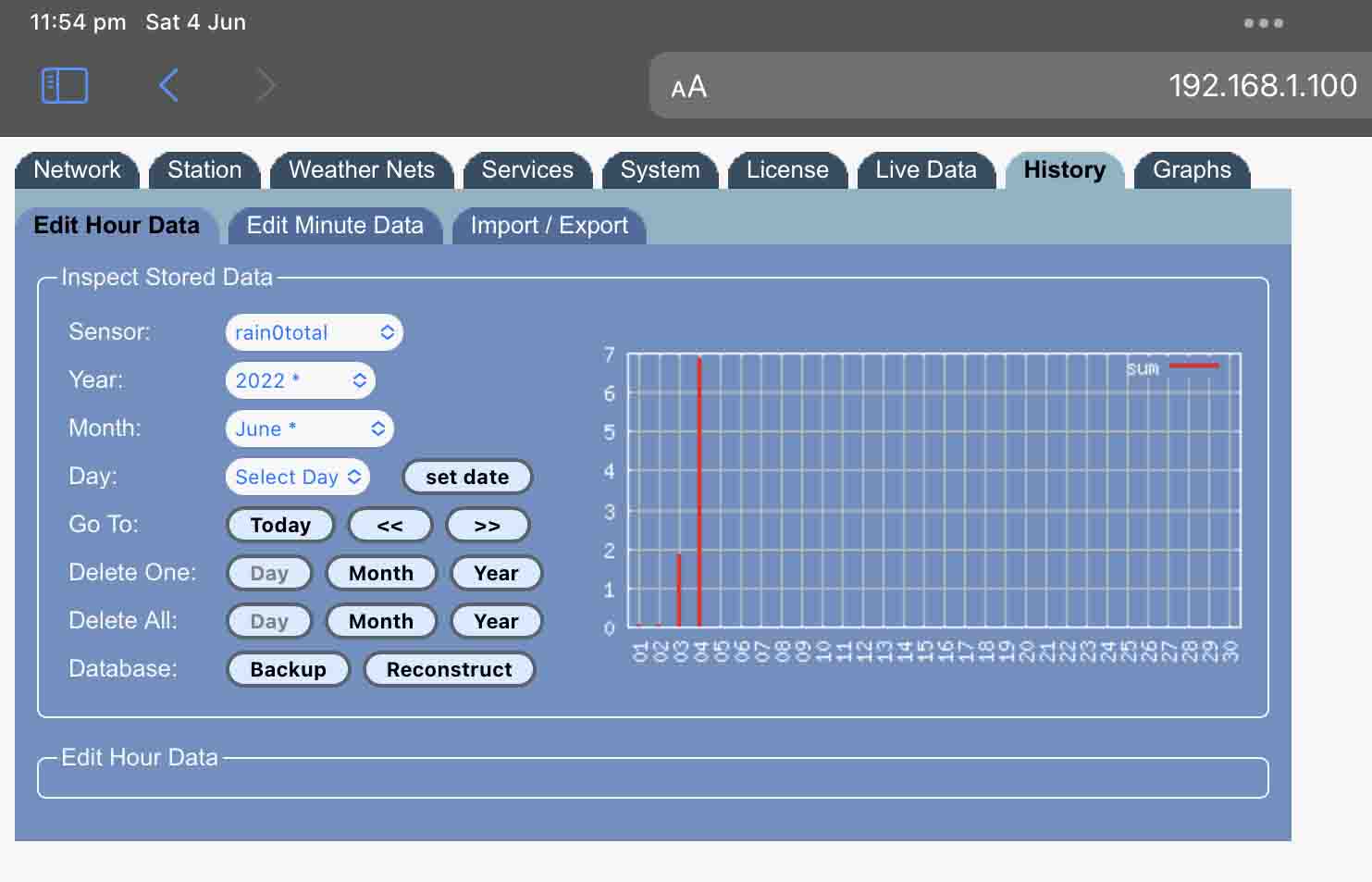

Note however that the rain total for the 4th of June is in error. The rain total for the month increments very slowly during the day, both on the max/min table and also on the hour data as below. Note that the Hour Data and Max/Min data errors are different. The error becomes increasingly larger during the day as shown below.
1
1
JPEG image.jpeg (65.98 KiB) Viewed 891 times

Hour data at the end of the 4th June, just before midnight.
2
2
JPEG image 2.jpeg (124.25 KiB) Viewed 891 times

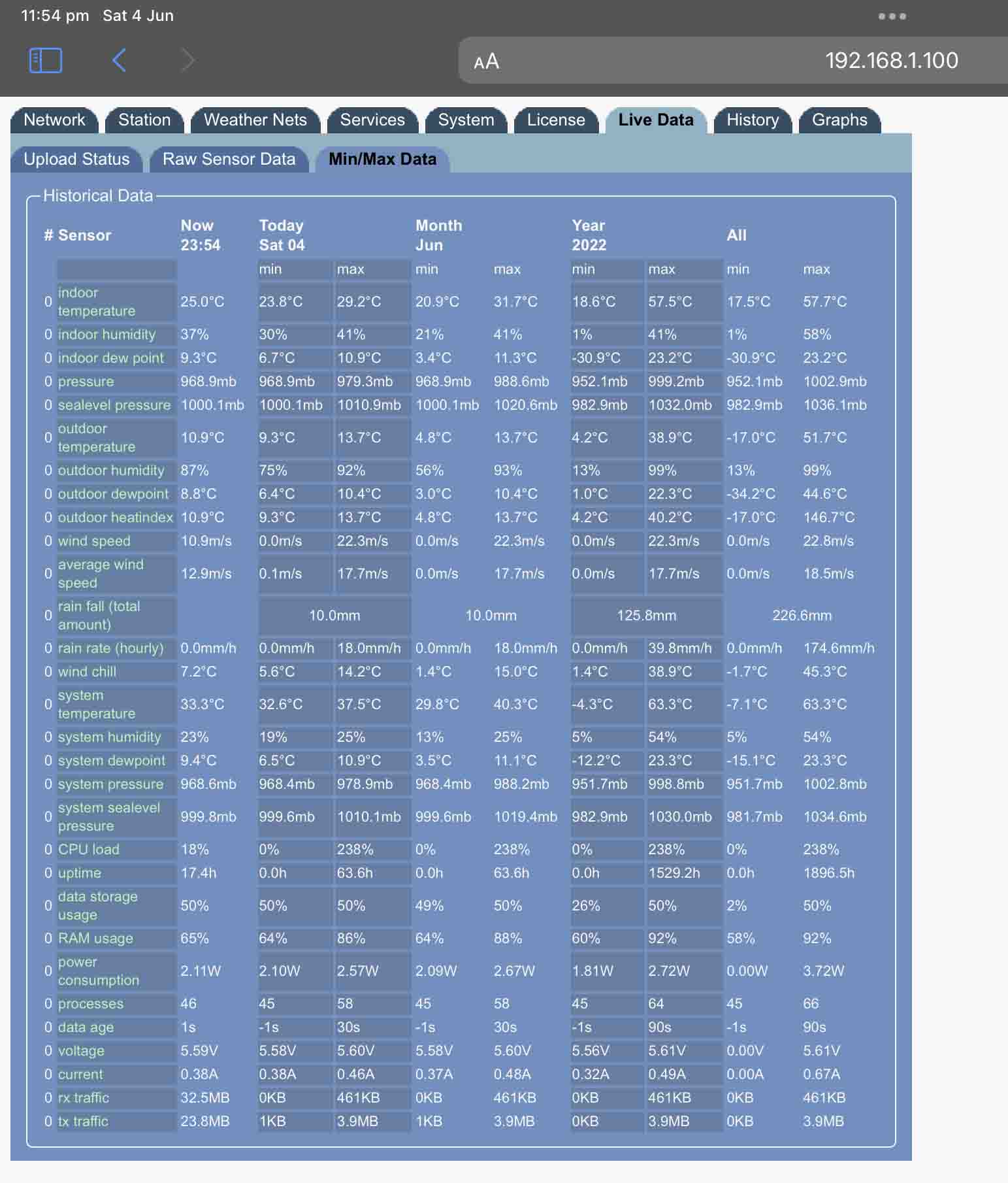

Max/Min data showing error in total rain for the month of June.
The actual rainfall for 4th June was 10mm. The max/min above registered the rainfall for the day of 4th June correctly as 10mm, as does "the all in one chart" in the Chart Generator section.

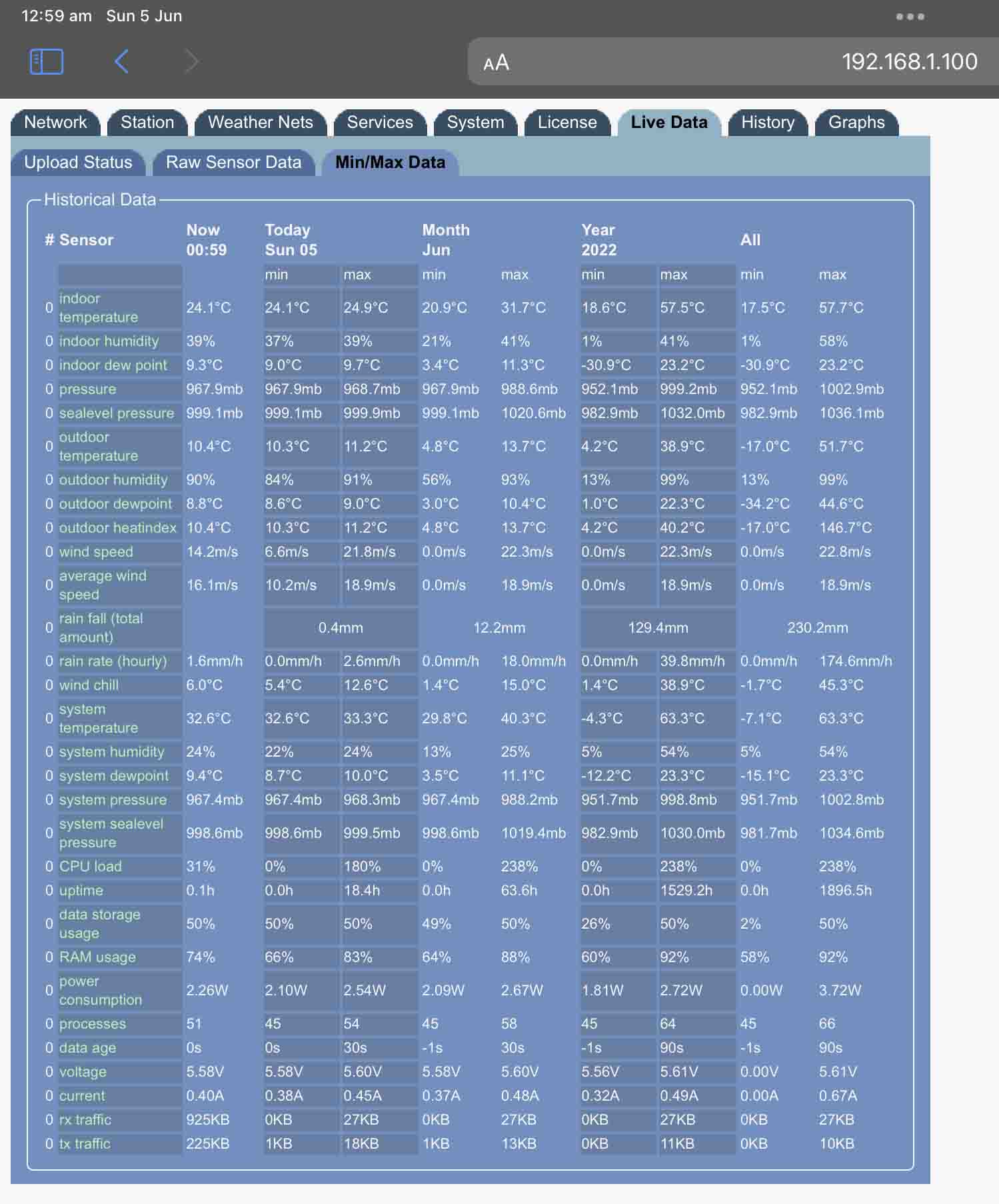

Hour data after reboot early on 5th June, showing corrected data.
5
5
JPEG image 5.jpeg (122.28 KiB) Viewed 891 times
