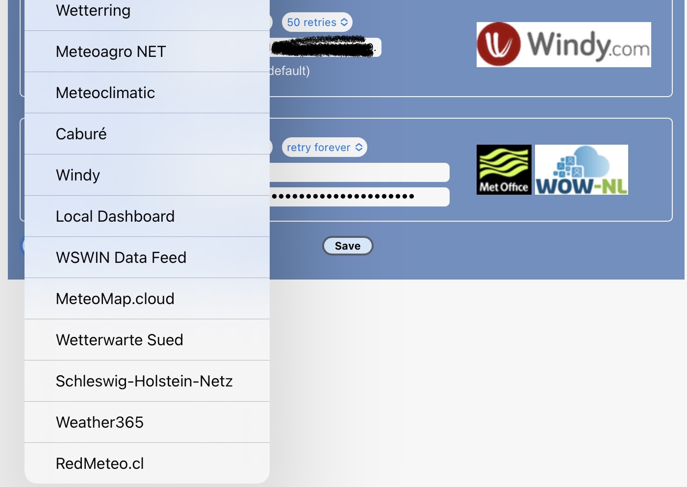

Login into your Meteobridge
1. Tab "WeatherNets"
2.1Click at the bottom "Add more Weather Networks"
2.2 Select nearly at the bottom "Weatherlink cloud"
3. Then add your credentials to the new WL Cloud box.

Unfortunately I don’t have that option at the bottom of the add more weather networks list?

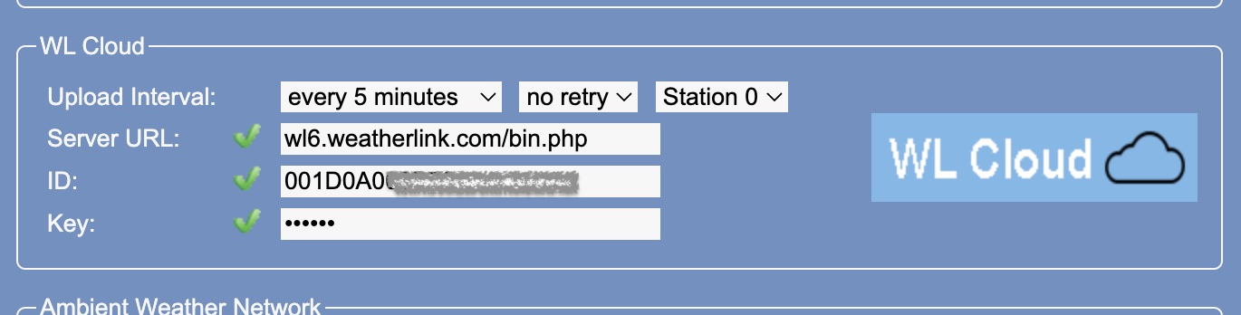

Re: Weatherlink upload
Yes. You use only once the weatherlink-PC program to register the logger to weatherlink.com
You will get a "fake" MAC address which you use as ID and your weatherlink.com password to enter it in the key field.

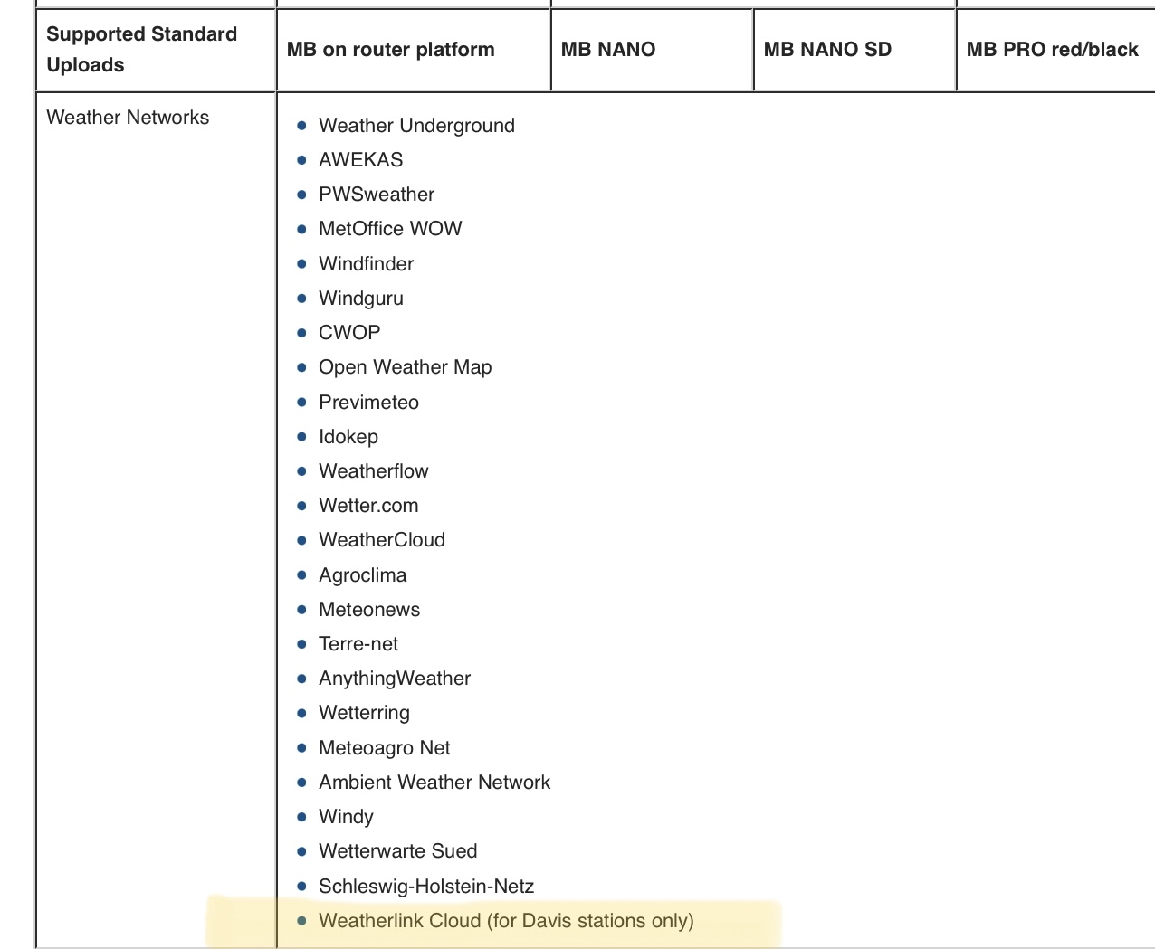

AFAIK you need a davis console attached to a Meteobridge.
This is from the original announcement https://meteobridge.com/wiki/index.php/Forum
released October 6, 2019
adds support for a new personal weather data upload service named "WL Cloud".
This feature is only available for Meteobridges connected to a Davis data logger (Console or Envoy, not Envoy8x).
It directly uploads data from the logger (not data from the Meteobridge) to an URL of your liking.
Data consists of LOOP, HILOWS and DMPAFT data sets as provided from the Davis logger.
Upload format is similar (and might be compatible) to what Davis uses to feed their weatherlink network.
https://meteobridge.com/wiki/index.php/Weather_Networks
====> Additional Weather Networks
Weatherlink Cloud if you have a Davis console or envoy connected by a NANO, WLIP or USB logger you can also feed data to Davis WeatherLink network
===> Examples
Davis WeatherLink
In case you are having a Davis logger connected (WLIP or USB) or are using a NANO the Meteobridge can feed the Davis Weatherlink network. You just need to enter the upload frequency, which station to take data from (in case you have more than one Davis station connected) the default server URL to the Davis network "wl6.weatherlink.com/bin.php" the ID given to you by Davis to identify your station within their network and a corresponding key
