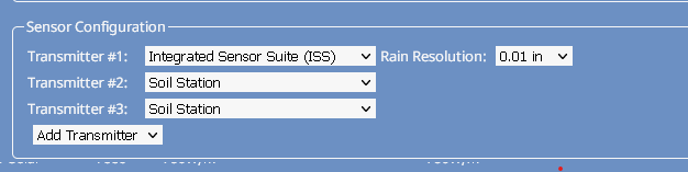

I recently added a second soil station (so 2 soil stations and 1 vantage pro 2 ISS). However, I noticed that for the second soil station, Meteobridge will only show a moisture reading if there is also a temperature sensor connected to the corresponding temperature slot (i.e., I have a soil moisture sensor in slot 2, another in slot 3, and one soil temperature probe in temperature slot 3, so Meteobridge only shows the data for slot 3 and not the moisture reading from slot 2). This is only the case for the second station. For the first soil station, Meteobridge shows data from all slots regardless of if there is actually any probe connected to it at all.
My stations connect to a WeatherLink Live and I have the latest version of Meteobridge.

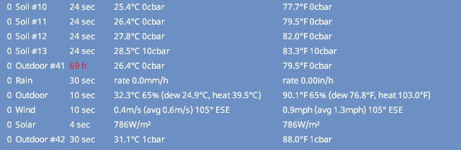

The data does not show in “Raw Sensor Data”. For the soil moisture sensor in slot 2 (there is no soil temperature probe in the corresponding slot 2), when I include what that sensor should be (th41hum) in an SQL event, there is no data.
In the picture below you can see where Outdoor #41 was previously working (when I had a soil sensor connected to that slot (i.e., th41temp), but I switched the temperature sensor to the third slot, so Outdoor #42 now shows data only).

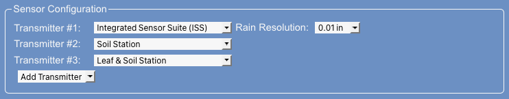

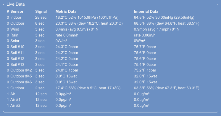

When meteobridge has this station configured as follows, data comes in fine (outdoor #42, #45, #46):
Bildschirmfoto 2022-06-24 um 11.57.16.png (84.98 KiB) Viewed 1305 times
Bildschirmfoto 2022-06-24 um 11.57.41.png (23.48 KiB) Viewed 1305 times
