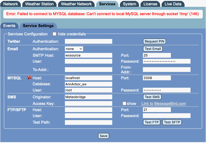

I'm running a local MySQL 8 on my iMac and can access it via command line but not from within meteobridge. Anyone had this issue and found how to get it to work?
Screen Shot 2022-06-21 at 8.50.38 PM.png (78.56 KiB) Viewed 871 times
Re: MySQL Can't connect to local MySQL server through socket '/tmp'
"localhost" means that the database is on the Meteobridge, which it is not ;-)
You have to specify the IP of your Mac here.
