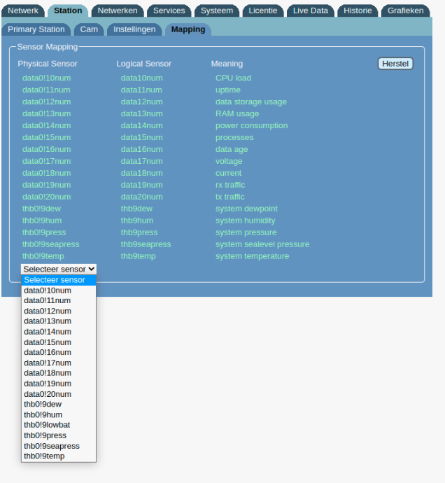

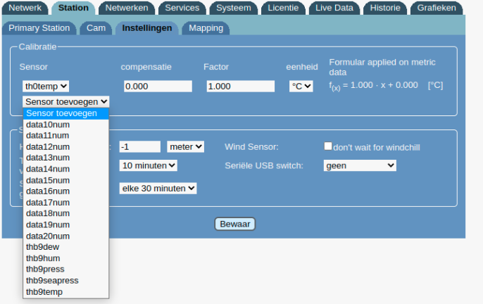

after a hardware crash the sensors like outside temp, humidity etc are gone. Are also no longer in settings or mapping. How do I get it back.
I have a meteobridge pro and software: Meteobridge 5.4 (Jun 11 2022, build 14754), FW 1.4.
see Attachment.

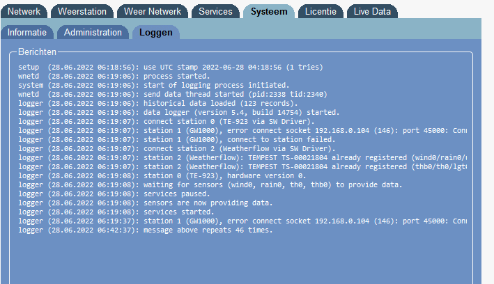

To renew & concentrate upload of my sensor data recently purchased a Meteobridge/Standard.
Main objective to get an alternative uploader for data from my TFA_Nexus.
Connection of TFA_Nexus, Tempest and GW1000 seemed easy enough,
but the Meteobridge is frequently loosing the sensor-mapping, resulting in 'no uploads'.
Reset is easy & rude by power recycling, but the need to manually monitor & correct was not the intention ......
Error log is below.
Errorlog_Meteobridge
2022-06-28 (2).png (47.83 KiB) Viewed 1909 times
Have seen similar topics/messages in this forum, but puzzled related to cause of the 'loss of mapping', because for TFA_Nexus the normal startup and upload seems to work for some time after reset. Other sensors not yet included in any upload.
Only (perhaps) suspicious aspect I see in the error log is that GW1000 is apparently not found at expected port 45000.
But read-out of GW1000 by other software seems OK ......

Re: sensors gone
Only sensors that provide data are listed.

:oops: GW1000-problem seems solved.
As result of reset GW1000 apparently shifted it's IP-address.
Had missed that shift: now (re)aligned.
Also found that via tab System > Administration you have access to a 'normal' Restart-button (at righthand-side bottom of webpage)
:( Learning curve .....
