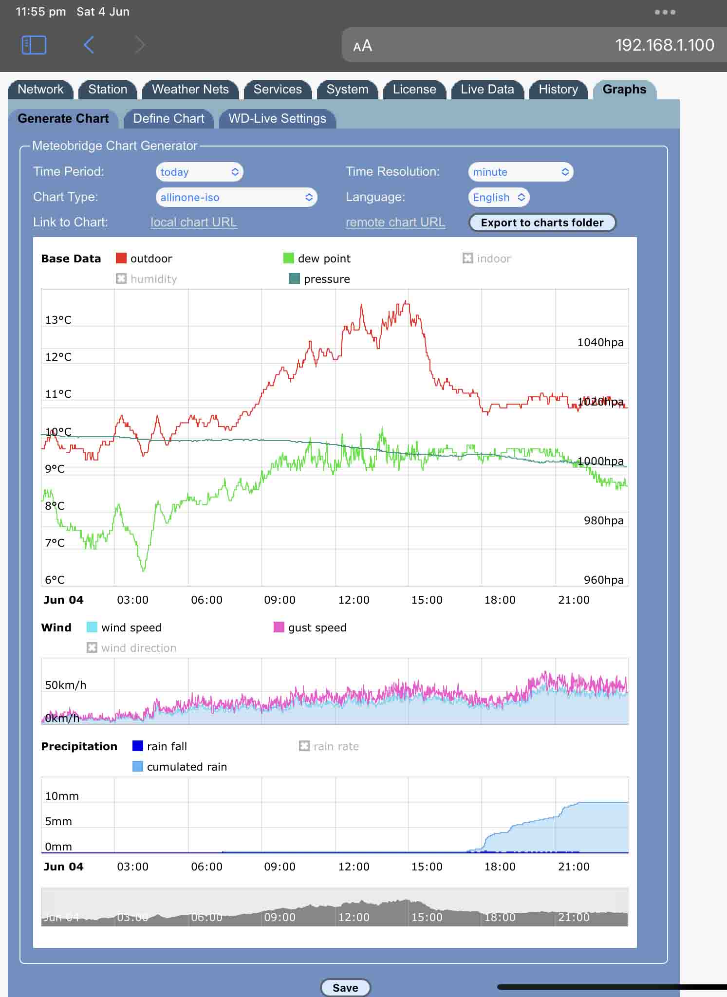

As I described in my original post I have shown the data error becomes more obvious as either time passes or more rain falls.
Please refer to my original post for the explanation again as follows;
These screenshots are all from a Meteobridge Pro.
Please note the first screen shot which shows accumulated rainfall for the 4th June at 11.54pm as about 7mm.
However, please look at the next screenshot, which shows the total for 4th June at 11.54pm as 10mm under Max/Min data for the day Saturday 4th June.
Next Image 3 which from the time stamp shows the Max/Min data on 5th June at 12.15am. Please note the rainfall totals for the "month", "year" and "total" columns.
The system has rolled over to a new day (5th June) and no rain has fallen as yet.
As I described the "all in one chart" in the graph generator section, shows the rainfall just before midnight on 4th June as 10mm.
Here is a screenshot of the graph for 4th June, just before midnight.
So at this stage rainfall total data for the 4th June just before midnight varies between 7mm and 10mm.
Next a reboot is performed.
Please look at screenshot 4 (12.58am on 5th June) which shows the hour data column now at 10mm for 4th June. The data now agrees with the graph total for the day of 4th June, 10mm.
Please look at the next screenshot, which shows the max/min data at 12.59am on 5th june. This is after the reboot as indicated above. Note the rainfall totals for "month", "year" and "total" have changed several mm although only 0.4mm has been recorded as a daily total so far for 5th June.
As you can hopefully observe the error is real.

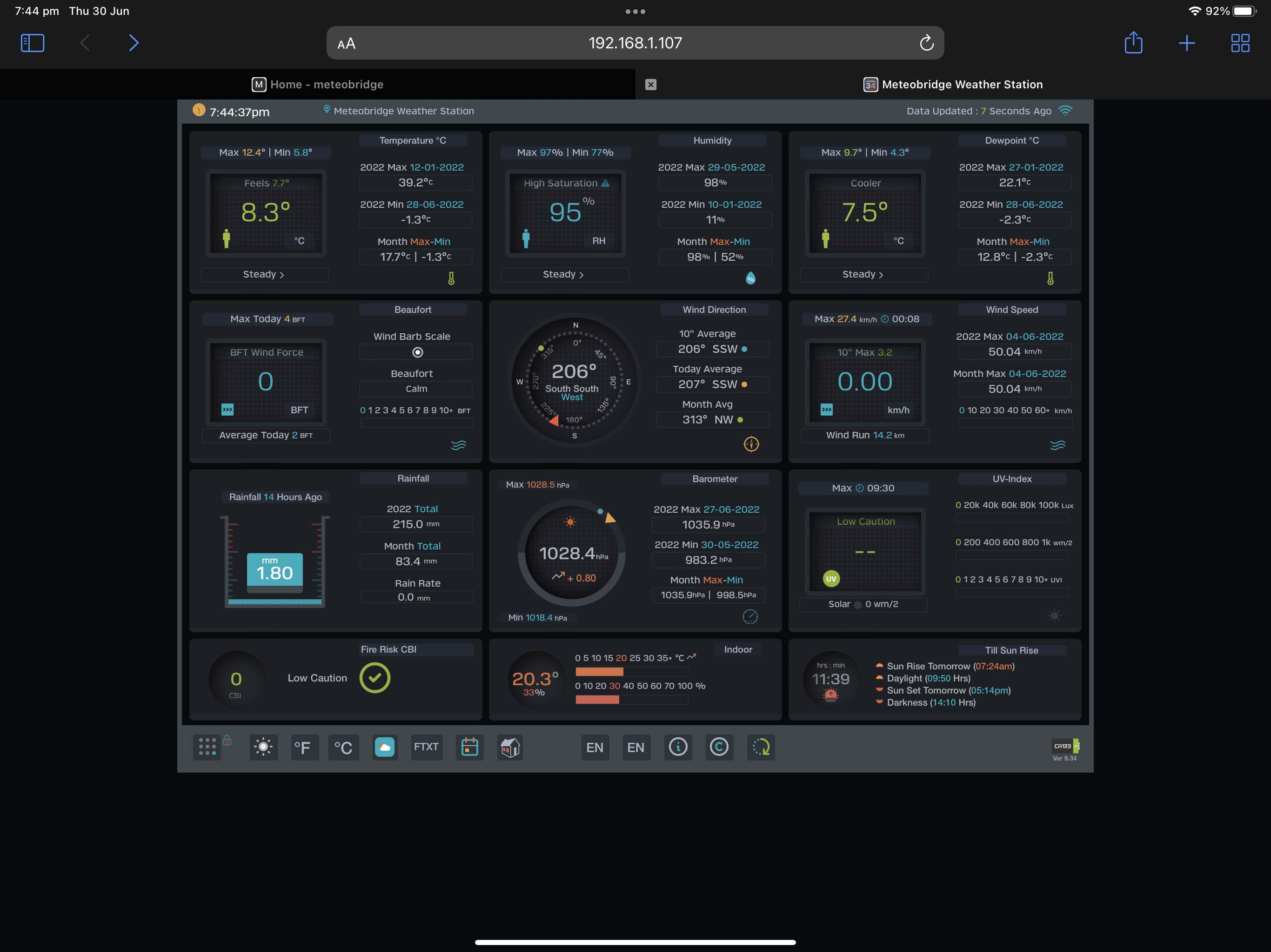

The following clearly shows the rainfall error on a Nano SD fitted to a Davis Vantage pro 2 Console.
This device operates with factory default settings except for those that are set up for network connection to the local network. No data is sent from this unit to cloud services via the internet. This device and the console has been operating for about one year. The internal SD memory is only 20% used.
The Nano SD is running the latest firmware from your webpage and was rebooted at about 6am on the day of the attached screenshots.
The first screenshot shows 1.8mm rainfall so far for the day. The totals for the month and year are 82.6mm and 214.2mm respectively.
The next screenshot is following a reboot. Please note that no rain has fallen in the few minutes in time between the two images. Note however that the rainfall totals for the month and year are now 83.4mm and 215mm respectively.
These screenshots clearly show the rainfall data error. please note that the max/min data for the Nano SD reflected this data at the time of the above screenshots.
The change in data between screenshots following the reboot is small. This is because a previous reboot was performed at about 6am of the same day which corrected the rainfall totals at that time, hence the correction is not as large as the 1.8mm of rainfall for that day.
This rainfall error and the effect of a reboot is observed in exactly the same manner with the Meteobridge Pro.
Please note that the rainfall error continues to grow larger each day as the rain falls, only correcting after a reboot.
